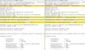

Still no answer on the migrate.inf syntax? Well Ive used Filemon and stored the values in txt files. I used filemon under the delay and right after when windows started to copy the installation files to the HD. There was actually no difference on those two files except what is shown in the attached picture. And I have no clue what the diffence means... any good ideas?
