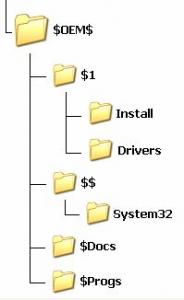

bump Sorry, just trying to resolve this last issue as I can't seem to find the problem. I can do complete installs without any issues now (not sure about the hotfixes), except that I can't seem to get any programs to install. It seems to just skip over the program install even though the install message pops up and looks like it's going to work. I only tried one app and reg tweak to keep it simple. Edit: I tried again with another program, but didn't install either. They are in the C:\Install\Applications folder after the OS is installed, so at least that's working right. Should they be extracted first? cmdow @ /HID @echo off SET KEY=HKLM\SOFTWARE\Microsoft\Windows\CurrentVersion\RunOnceEx REG ADD %KEY% /V TITLE /D "Installing Applications" /f REG ADD %KEY%\001 /VE /D "Preparing Installation..." /f REG ADD %KEY%\001 /V 1 /D "%systemdrive%\install\prepare.cmd" /f REG ADD %KEY%\005 /VE /D "ZoneAlarm" /f REG ADD %KEY%\005 /V 1 /D %systemdrive%\install\Applications\ZoneAlarm\zlssetup_45_594_000.exe /s /noreboot /f REG ADD %KEY%\050 /VE /D "Importing Registry Tweaks" /f REG ADD %KEY%\050 /V 1 /D "REGEDIT /S %systemdrive%\install\!SafeProAllstart.reg" /f REG ADD %KEY%\055 /VE /D "Cleaning Up and Rebooting" /f REG ADD %KEY%\055 /V 1 /D "%systemdrive%\install\cleanup.cmd" /f EXIT
I can do complete installs without any issues now (not sure about the hotfixes), except that I can't seem to get any programs to install. My reg tweak is I think, but it seems to just skip over the program install. I only tried one to keep it simple. Edit: I tried again with another program, but didn't install either. They are in the C:\Install\Applications folder, so at least that's working right. Should they be extracted first? cmdow @ /HID @echo off SET KEY=HKLM\SOFTWARE\Microsoft\Windows\CurrentVersion\RunOnceEx REG ADD %KEY% /V TITLE /D "Installing Applications" /f REG ADD %KEY%\001 /VE /D "Preparing Installation..." /f REG ADD %KEY%\001 /V 1 /D "%systemdrive%\install\prepare.cmd" /f REG ADD %KEY%\005 /VE /D "ZoneAlarm" /f REG ADD %KEY%\005 /V 1 /D %systemdrive%\install\Applications\ZoneAlarm\zlssetup_45_594_000.exe /s /noreboot /f REG ADD %KEY%\050 /VE /D "Importing Registry Tweaks" /f REG ADD %KEY%\050 /V 1 /D "REGEDIT /S %systemdrive%\install\!SafeProAllstart.reg" /f REG ADD %KEY%\055 /VE /D "Cleaning Up and Rebooting" /f REG ADD %KEY%\055 /V 1 /D "%systemdrive%\install\cleanup.cmd" /f EXIT

The problem with my issue evidently was I didn't have the directory structure set up properly in the $OEM$ folder. Once I changed it to the attached pic (including the I386 folder not shown), it installed fine. Not all hotfixes installed, at least according to Add/Remove. No big deal, I'm just happy to get this far. Now that it appears the basic install is working, it's time to refine and add. Thanks for the help shareef59, I hope you are willing to be of assistance for a few other questions, I really appreciate it. This is a great utility and saves a lot of time.
