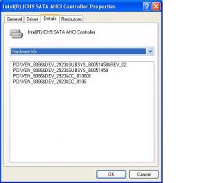

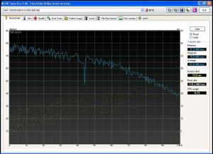

OK, so I guess you mean this screen. I dont really know what I am looking at there, but I wish i could see something that showed me that my specific drive was being recognized and working under a specified transfer rate. When I look at these entries, i think i am look at the ability of the controller to handle certain types of drives, but i am not certain that i am seeing the fact that a certain drive is being recognized under a specific mode. Maybe it is right there, I dont know. I currently have the westerndigital drive, and I have a SATA liteon dvd drive hooked up. I dont know what the specification for the dvd drive is, but I suspect it is different from the harddrive. I ran HDtune to see if it would tell me anything. I dont know if anything can be seen from that image either as I have never used htune before. My main concern is transfer rates. I was worried that the default setup in my bios (gigabyte/award) was designed to take the sata drives and mimic pata/ide. I installed windowsXP yesterday, and i noticed the drives listed as DMA5. I was thinking that there might be improvement if the harddrive was actually recognized as sata gen2, so I found this thread and here I am. My thanks to everyone that has helped with this.

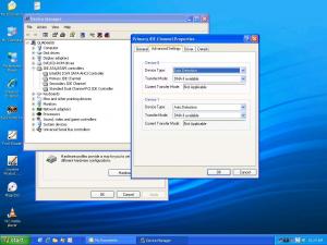

gigabyte ga-p35-s3g, winXpProSP2, WD5001ABYS (500gig sata2) I followed original directions, and at first I got the blue screen STOP. I deactivated sata settings in bios. Rebooted. I went back and right clicked the INF file and selected install, I also went to device manager and selected the IDE device and forced a driver update to the modified files from the floppy image. Changed bios to native sata with ahci. reboot. Windows boots now. Now I just dont know if it is correct. Without SATA enabled in the BIOS, the driver was showing the harddrive as an IDE using DMA 5. With this new intel driver, under "intel ICH9...controller" there is no info on the diskdrive or mode. I also still have listed 'Primary and Secondary IDE'. Under Primary IDE (advanced) device type is auto detect with mode DMA,...current mode is 'not applicable'. I cant tell if this is correct. Are the entries for Pimary and Secondary IDE remaining from the prior driver/prior bios entry? or are these supposed to be there under the AHCI driver? Should I see my SATA interface listed somewhere else. I was expecting a tab with options to turn off NCQ, and info on the current transfer mode (something like "SATA generation 2 3G") I also have a sata dvd burner (liteon) installed and working. I am used to seeing the individual sata chanels listed with maximum transfer rates, and current drives plugged in. I am not seeing them here, and I want to know if I installed the driver correctly, or if maybe I missed something, or need to install something else. Does it look this way for everyone? As a side note, at this point, with the driver installed, if I delete the device entries and reboot, will it boot or will it bluescreen again? --- ubcd4windows, I built this cd in november of 07. I had to disable AHCI in bios to get it to boot. (I was able to leave 'native-sata' enabled). I think someone mentioned getting AHCI to work under this environment. Maybe it is a later build, or other drivers were included (slipstreamed). Not exactly on topic, but if anyone is hitting bluescreen with this PE based boot cd, it may be the AHCI.
