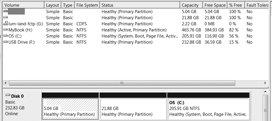

I discovered that even though I can boot from the XP partition, I can't get it to be drive C. Since some programs only install to C this will be a problem. So it looks like I need to reinstall that. I expect it will be the same for the Vista installation. I've decided not to proceed with this until I can figure out how to stop my external drive from being hidden. My first thought is to change it to a logical partition.
I have attached an image from Disk Management. The installation that needs boot files is the second partition on Disk 0. I forgot that the external drive that OSL is hiding is marked Active. That is probably what is causing OSL to hide it.

I understand that. Fixing it in XP is simple and I've already done that. I don't know what is involved in fixing it in my second Vista installation. But I can fix it by making that partition active and then reinstalling. This point brings up what I consider to be bad advice in the OSL docs. They recommend installing all OS's and then install OSL. This leaves out that you should make the partition active before installing the OS.
