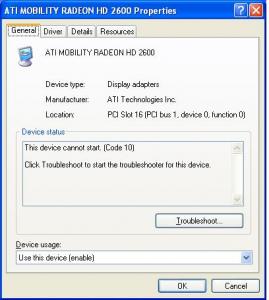

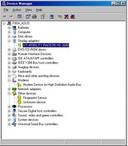

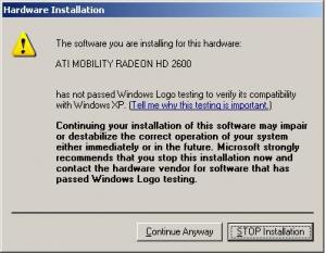

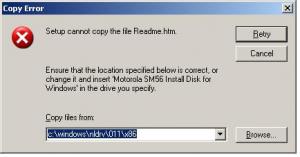

  6. Greetings. I am using nlite to crate an unattended XPCD with device drivers slipstreamed for a new F8SA laptop. The integration and installation proceeded smmothly, but upon bootup, i noticed two devices were not properly installed. 1. Motorola SM56 modem The culprit appears to be a missing README.HTM file, which was not found in the NLDRV folder on the nlite CD. If I copy the file over to the NLDRV folder and edit the TXTSETUP.SIF file adding the readme.htm entry, the new nlite CD will install the modem properly. For your info, LICENSE.HTM was copied over to the NLDRV folder, but README.HTM was left out. Are there any settings in nlite that could have caused this rather strange behavior? and how to get around this problem? 2. ATI HD2600 Catalyst 7.12 There is an error message in the device manager "This device cannot start [code10]", and the adapter would only work after pressing the update driver button. Checked the registry and all the relevant entries were present,. Drivers files were also copied to the system folders . Just wouldn't start. I use the Driversheaven modified inf for installation, so this is an unsigned driver. But the WINNT.SIF file contains the two ignore Drivers Policy entries which I thought would take care of such issues. DriverSigningPolicy=Ignore NonDriverSigningPolicy=Ignore Would appreciate any help. Thank you. LAST_SESSION.INI

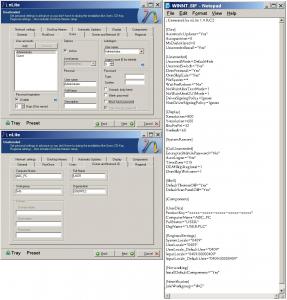

  7. You are right, snowden. Fully unattended setup works with UnattendMode=DefaultHide. Thanks for clarifying. Best regards.

  10. Many thanks for your reply, mara-. But it's now asking for administrator's password. What else should I change? Best regards.
  11. Greetings. Need help with a little problem using nlite to make a fully unattended setup CD. I have selected the option to log in as administrator without password, and have the computer/user/company names entered. Yet setup would pause and ask for the computer name to be confirmed. What have I done wrong? Many thanks for the help.
