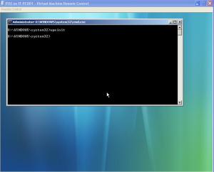

Firstly Hi to all. Secondly I apologise in advance for the length of my post, I want to give as much detail as possible and hope somebody can advise Here goes: I have been attempting to deploy an XP Pro image using WDS installed on a Windows 2003 R2 server (all running on VS 2005 R2). All the documentation I could find initially discussed deployment of VISTA images via WDS. However I found an article that described how to successfully deploy Windows XP Pro using Windows Vista PE from the WAIK (WinPE Zip file): http://sociallybeta.blogspot.com/2007/03/w...-using-wds.html virtual machines: VM1: Windows 2003 R2 SP2 512MB RAM / 2 * HDD C: 16GB & E:16GB (WDS Configured) VM2: Windows XP Pro SP2 512MB RAM / 2 * HDD C: 16GB & E:16GB Installed the following on the Windows 2003 Server VM WAIK (Windows Automated Installation Kit) Business Deployment Desktop 2007 I followed the article and all appeared OK until I attempted to deploy the captured image to a bare metal VM. So this is what I have done to date: I extracted F1_WinPE and F3_WinPE from WAIK In the WDS MMC right click the "Boot Images" folder and select "Add Boot Image" Browsed to the location I saved the WinPE images extracted earlier: ‘F1_WinPE and F3_WinPE’ Added both images. The images appear in the "Boot Images" folder. Right clicked the "Windows Vista PE" image and select "Create Capture Boot Image" Named the capture image ’Windows XP Pro SP2’ and selected a place to save it and click Next Right clicked the "Boot Images" folder and selected to add another boot image Navigated to the location I just saved you capture image and imported it to WDS The capture image appeared in the "Boot Images" folder Installed Windows XP Pro on the workstation along with Office 2007 Created a folder in the root of the C: drive called sysprep From the XP Pro CD I copied contents of ‘Deploy’ from the support folder to C:\sysprep From sysprep folder I ran "setupmgr.exe" to create the answer file needed for an automatic installation on Windows. I have tried 2 options to date: Sysprep & RIS. I saved these to the default location offered on C drive. The from the sysprep folder I ran the sysprep executable Ticked the box "Use Mini Setup" and click the "RESEAL" button /Shutdown On restart I selected to PXE boot (F12). The workstation was issued a DHCP address from the WDS server. A text-based selection screen appeared. I selected the capture image created earlier Windows XP Pro SP2’. Windows then displayed “Windows is loading files” and a progress bar. This took 1-2 hours (maybe because I am working in a virtual environment?) I followed the steps to image the appropriate volume C and chose a location on the local drive E: to save the image. This ran to completion and the XP workstation imaged OK. I then re-booted the client in order to copy the .wim image to the WDS server. On the re-boot in went through the XP Pro installation as if deployed from WDS . The desktop eventually loaded. I navigated to drive E: and copied the captured image to a network share ‘captured_images’ on the WDS server On the WDS server right click "Install Images" and selected to add an install image. I browsed to the location I saved the sysprepped image just copied to the server and selected it. The XP Pro image displayed in the "Install Images" folder. i started a bare metal VM with the same HAL as the image machine (HAL independence is only a feature of Vista images) and hit F12 for PXE boot. I selected the "Microsoft Windows Vista PE", NOT the capture image as before. Once again Windows then displayed “Windows is loading files” and a progress bar. This took 1/12 hours to complete. When complete NOTHING? Just a command prompt: X:\Windows\System32>wpeinit followed by X:\Windows\System32> This makes me think that I have failed to implement something pretty basic? Maybe the .sfi file captured needs to be copied to the WDS folder? I have read a little regards creating a clientunattend.xml file but was led to believe that my approach above took care of all of that? Anyone had this issue? Advice very much appreciated. Phil.
