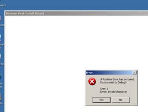

Anyone have any clues on this one? Still getting it randomly, claims there is an invalid character on line 1. I assume this is suppose to be in the rb_config.js I don't see anythign that looks like an invalid character, does anyone else? The js file is attached to the third post in this thread. Any clue what would be causeing the change if there is an error? Appreciate any help I can get, I am done with what I need this for for the most part if I can solve this issue. Thanks!
Perhaps this is creating the problem? I noticed when the WPI resumes itself it calls the installer.hta proceeded by the mshta command. When mine resumes, I have been killing that reg entry (Before Reboot) and calling the installer.hta file directly with a script and I have not been proceeding it with the mshta command. Could this possibly be the problem? Even if I just go back and run wpi.hta and say resume on previous install I still get the runtime error if I have received it before. Nothing but canceling the install will allow me to use the wpi again.
Curious if someone could take a look at this and let me know if I did something stupid. I am getting random Runtime errors when calling the common\installer.hta after a reboot. Mostly happens after the default user entry you see in my config file. Let me know if there are any others files I need to post. Thanks! config.js useroptions.js
