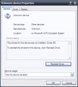

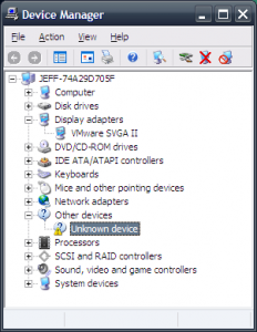

About tronsr71

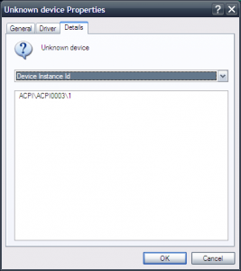

  2. Alright.... so I think I found the culprit... I'll have to test it first, however to confirm. I looked at another XP virtual machine of mine that I had not removed so many dang components. It, of course had no issues in the device mananger. One thing I noticed right off the bat was that there was this thing called "Microsoft AC Adaptor" as a device listed under batteries. Sure enough when I went to the details tab it's device instance ID was ACPI\ACPI0003\1. I am going to add the battery component back to my stripped down version of xp and see if that solves my problem. Will promptly update in roughly 30 minutes.....
  3. Ok, good suggestion.... here is the screenshot of the details tab... I did do a google on it and did not come up with much. Since it says ACPI0003, I tried changing the acpi setting from default to "Advanced Configuration and Power Interface (ACPI) PC". This did not solve the problem. Next I will try Uniprocessor. UPDATE: uniprocessor did not work either
