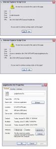

  3. Hi, Has anybody come across following error? *********** Begin Error **************** An error has occurred in the script on this page. Line: 380 Char: 26 Error: Permission denied Code: 0 URL: about:blank Do you want to continue running scripts on this page? *********** End Error **************** I am using Windows XP Service Pack 3, v.3244 and user is Administrator. This happens only if I set ReOpenAfterInstall=true; in 'useroptions.js' If ReOpenAfterInstall=false, it installs and closes successfully For more info see the attachment. Thanks, wpi.zip
  4. Here is how I solved "Internet Explorer Script error" with WPI: Use "Properties" window and click Unblock for following files. 1. ..\WPIScripts\pngbehavior.htc 2. ..\Common\Installer.hta Also see: wpierror.jpg Hope this helps. Anita

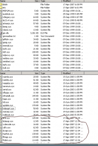

  5. Hi, Here is the update on this issue. If MAKECAB Directive is given via .ddf file like one given for driver.cab MAKECAB /F UC.DDF - Works fine and after windows setup, installed file date stamp is same as original whereas any file created without .DDF directive like on below MAKECAB /D CompressionMemory=%COMPMEM% /D CompressionType=LZX "%ALTSRCDIRS%HFEXPERT\STORAGE\%%I" /L SOURCESS\I386 >NUL gives wrong date stamp. - after windows setup, installed file date stamp is current date and not original file date Even with files from original CABSDK (1997 version), error persists. But here if expand/extract directly to a folder it shows original file date, but after windows setup, it shows current date instead of original file date. Hope above points will give some clue. Attached is the directory listing of Windows 2000 driver folder after windows installation. Marked files are the files added via HFExpert - Drivers / Storage folders. same for HFExplert - Win folder. Work environment: OS=WinXP sp2 Pro HFSVER=70325 Anita K
  6. Hi the_guy. Thanks for the reply. I will try with different version of Makecab.exe and will post the result here. Anita K
  7. Hi All, All the new files added via HF folder and HFEXPERT subfolders and files inside driver.cab ultimately got stamped with current date and time. Is there any way to retain original date and time of files. Is it a makecab issue or am I missing something here? Test Installation of both WinXP sp2 and Win2000 sp4 went through fine except for Date stamp. Work environment: OS=WinXP sp2 Pro HFSVER=70325 Thanks, Anita K
