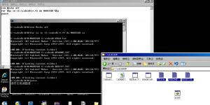

hi fdv, first, download makecab from the following link http://support.microsoft.com/kb/310618 then 1. create a empty file 2. copy the code under into the file 3. change c:\makecab to the directory that you would like to make all files into cab 4. save the as makecab.cmd (or anything end with .cmd) 5. put the cmd file next to the bin/MAKECAB.exe you just downloaded from microsoft. 6. double clicking the cmd should make all the files in directory c:\makecab into a xxxx.xx_ rem @echo off for %%a in (c:\makecab\*.*) do MAKECAB %%a pause
