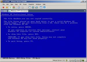

c. Then, during textmode setup, I get an error message: "The file dmadmin.exe was not copied correctly". In addition the file is claimed not to be a "valid Windows XP system image" (see attached screenshot for details). The other two files do not create a problem.

1. Help came when I was looking at how to disable WFP, which lead me to this post:
http://unattended.msfn.org/unattended.xp/view/web/64/
After applying
modifype dmadmin.exe-a
and then compressing the file as before
makecab dmadmin.exe dmadmin.ex_
The installation went through perfectly. So it was just a checksum problem. Interestingly, none of the guides I read mentioned this. But then they only described how to replace the files in a live system. I guess that Windows doesn't check the checksum then.
