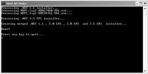

Stoner81 Posted December 22, 2008 Posted December 22, 2008 I dont use any language packs at all m8 i only use the installers plus updates since my language is English Thanks tho for the info im goin home shortly where i have no internet access so i will be running SNM_mod8.cmd and seeing how it goes with what im after and then i will report back to you m8 to say how its gone (good or bad )Hope this helps you m8 to improve the script and such... thank you for your hard work buddy!Stoner81.Ok strel its me again had no problems with SNM_mod8.cmd at all m8 save the minor niggle of the name of the merged installer which dont matter to much since you can just rename it Attatched is a screen cap of how the cmd prompt window looked after it had finished.
