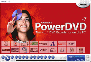

muiz Posted August 25, 2006 Share Posted August 25, 2006 (edited) First of all its MUIZ , not muez this is how mine looks like after install.As you can see with all plugins.So whats your problem? Edited August 25, 2006 by muiz Link to comment Share on other sites More sharing options...

embe Posted August 25, 2006 Share Posted August 25, 2006 (edited) Hi muiz, first of all sorry for distorting yr nick i was in work doing a thousands of things at once...My version shows 16 plugins, yours 17. I miss "CLHP"...I don`t know why, anyway. It works perfect now B) Thanks guys!EDIT: I found the same serial in these lines:"UI_PMK"="xxxxx-xxxxx-xxxxx-xxxxx-xxxxx-xxxxx""UI_RMK"="xxxxx-xxxxx-xxxxx-xxxxx-xxxxx-xxxxx"actualy, these must be different.... Edited August 25, 2006 by embe Link to comment Share on other sites More sharing options...
