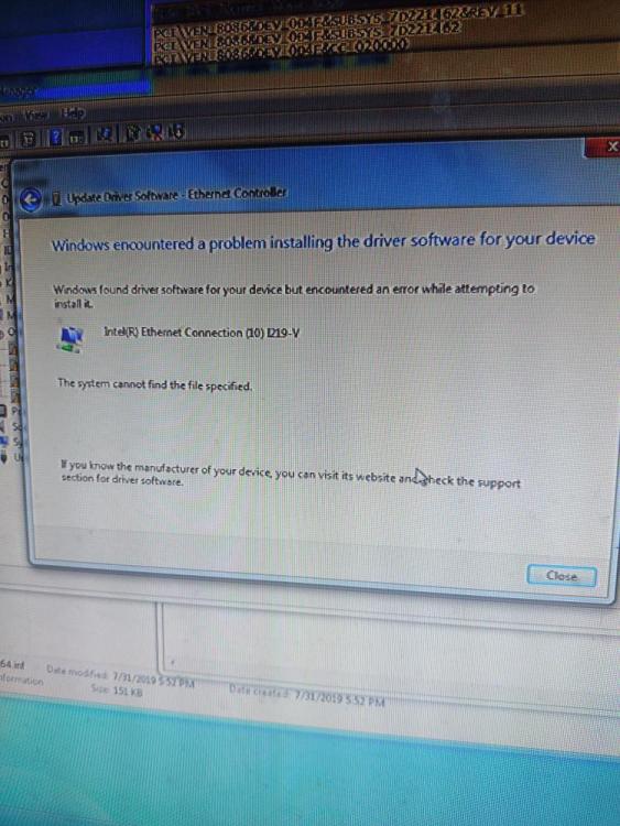

aiden99 Posted June 7 Author Share Posted June 7 20 hours ago, K4sum1 said: I have this driver lying around, not sure if it's one of the ones you've already tried, but if it still doesn't work I could try modding some drivers. https://mega.nz/file/3Y0VHTzK#f7KjHCPYvFHjTFtzTDNw84j-yxo3_pMCyjerBj0350I The driver is compatible with my hardware, but it gives me "The system cannot find the file specified." error. Link to comment Share on other sites More sharing options...
