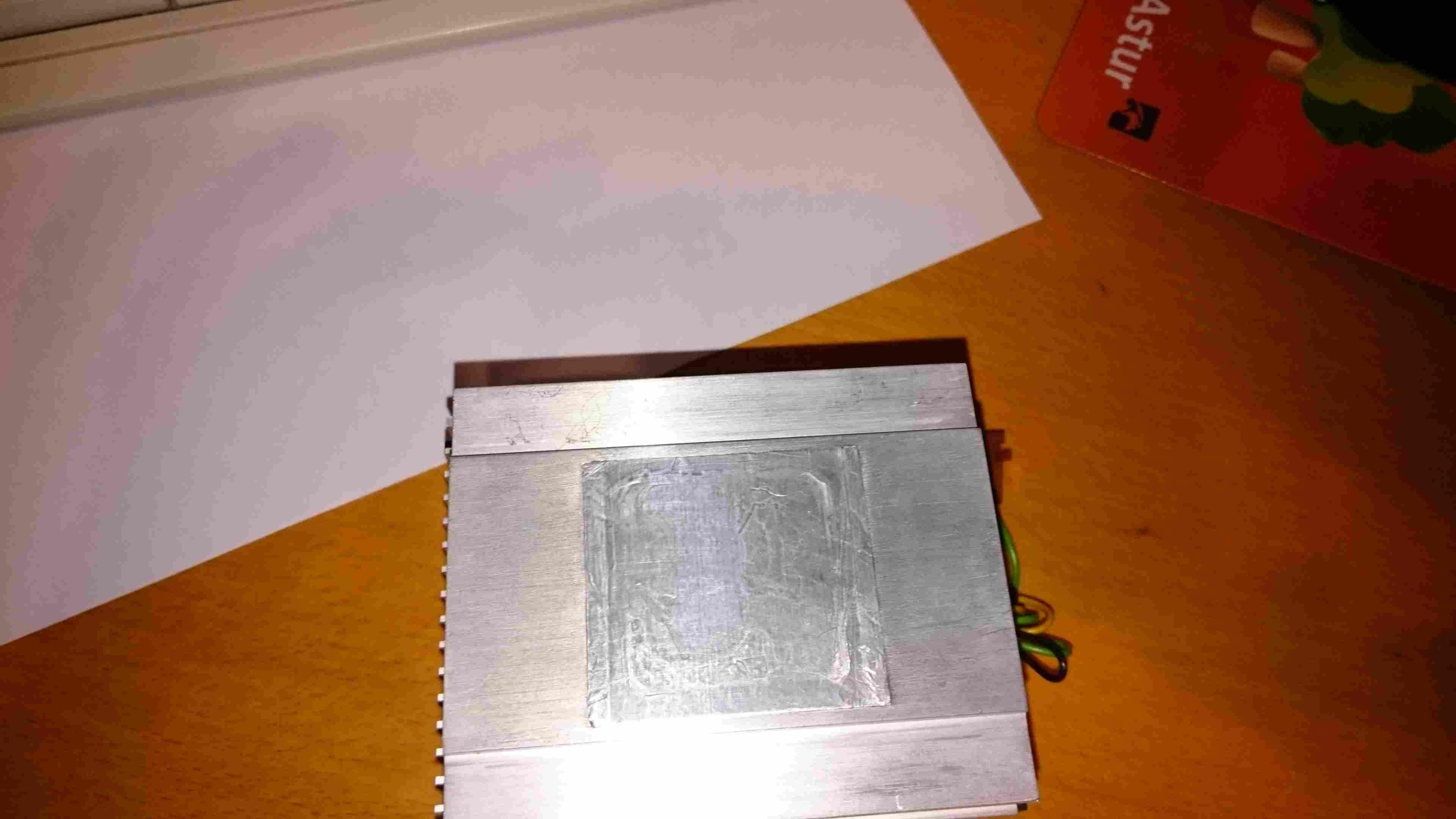

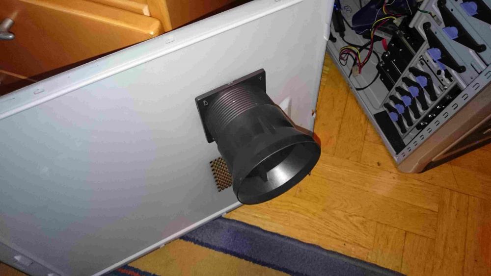

Cixert Posted June 30, 2020 Author Posted June 30, 2020 When I went to check the paste, the plastic that holds the closure has broken so I have changed the fan and heatsink. At the moment there is no temperature problem, it is around 57º C. and at the moment I have not put thermal paste. But I keep the computer cover open. I have several questions why the old fan could fail. It sounded weird, like it was forced to spin at high speed and couldn't cool down. I can think of several possible causes. 1-Fan too close to the heatsink could impede an air flow. 2-The turbine in the cover was too far from the fan, preventing air circulation. Here I think that either the turbine is approaching or it is suppressed. 3-There is a metallic sticker attached to the heatsink. Is this useful? When I touch it, it doesn't absorb the heat from my finger
TELVM Posted July 11, 2020 Posted July 11, 2020 2-The turbine in the cover was too far from the fan, preventing air circulation. Here I think that either the turbine is approaching or it is suppressed. ^ From the pic I assume you're talking about a side panel duct to feed cold air to CPU fan. A side panel duct is a cool (pun intended) idea for a P4, but unless it is well aligned with the CPU fan it might be doing more harm than good. If it is way misaligned I'd remove the duct and just leave the hole in the side panel. 3-There is a metallic sticker attached to the heatsink ... ^ I'd remove that crap from the bottom of the CPU heatsink and replace it with just any decent thermal paste. Buena suerte.
jaclaz Posted July 11, 2020 Posted July 11, 2020 (edited) Wait a minute. Which way does the fan spin? I mean usually (but not always) fans are made to extract blow air from towards the heatsink, not to blow extract air on from it. in this case that black conical thingy attached to the side panel is an exhaust intake and not an intake exhaust or viceversa it could have been (originally) an intake exhaust and now due to the changes in the heatsink and fan it has become an exhaust intake. My two cents (actually only one): DO NOT do that, i.e. DO NOT EVER run a processor without thermal paste (or a good thermal pad[1]) between it and the heatsink (it might take some time (from several seconds to a few minutes) to have two perfectly matching surfaces warp and become non-matching due to thermal expansion but it may happen (it may also not happen, of course). jaclaz [1] which is what you call a "sticker" in the photo, I am confused, you said you had put some thermal paste before (you don't use BOTH a pad AND thermal paste). Edited July 17, 2020 by jaclaz Corrected thanks to the input of an expert, qualified Mechanical and Electrical Engineer, inverting the factors, result does not change
TELVM Posted July 12, 2020 Posted July 12, 2020 The "metallic sticker" is a soft metal thermal interface. Some Intel CPU heatsinks from around the turn of the century were "blessed" with this extremely inefficient "thermal solution": Itanium disassembly That crap needs to be completely removed and replaced with decent thermal paste, specially so when dealing with P4 Burnwood/Preshott furnaces.
