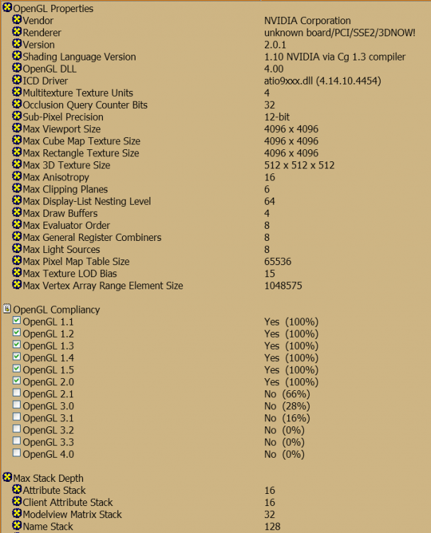

Experimental: WebGL 1  (tested with Firefox 47.0.2 and 52.9, Centaury 0.17, RT's FF 45.9.33)
I forced WebGL and I was quite surprised that it seems to work. Test pages give the spinning cube.
https://get.webgl.org/
https://webglreport.com/
The question is whether stability or any new problems arise. WebGL 1.0 is based on OpenGL ES 2.0 (March 2007).  But my OGL 2.0.1 is from February 2006 here. I had thought that I need at least OGL 2.1. Common issue: The browser exe causes an error in NVOpenGL.dll after close. Apparently this error doesn't cause any further problems. (about:support - no "Failure Log")
I haven't dared to make the stress test yet (https://testdrive-archive.azurewebsites.net/graphics/webglstresstest/).
layers.acceleration.force    true
webgl.force-enabled         true
webgl.angle.try-d3d11     false
webgl.disable-angle         true
Screenshot Troubleshooting Information Centaury 0.17

Take a process module Minisnap before exiting and again with the error dialog on screen. Post any diffs and the full error text.
Also try with API logging to DebugWindow.exe and profiled in Depends.
Link to comment
Share on other sites
It will be supported up to 66% of OpenGL 2.1 extensions though with 82.18 and 82.69. If there is a bad NVopenGL exit problem the program can be left in memory and cannot be terminated as NVopenGL did not release from memory when the program tried to detach (DW terminology). Otherwise there seems a delayed exit and there are no symptoms shown like your instance and the program exits. As well as what Jumper wanted, see if Firefox is still running with Starter or Process Explorer. My take on the NVopenGL is that the cube is very minimalistic and the exit problem could be a hardware issue. It seems NVopenGL needs exercising more. You could try Blender 2.64 or Make Human 1.02 etcetera to see if there is problems with exit there as well. One build of mine does not even display the Human and others work. Blender causes a NVopenGL exit error on that same build and another build does not have any exit trouble at all from Blender but has a python error on starting Make Human 1.02. It is the first time that I encountered a nondisplaying Human although with a non 2.0 card it can be non textured - white. (I am using a newly acquired video card as well as a different PCI SCSI card just recently changed but I think I can rule this out now because of the other builds characteristics).

I have to say  that OpenGL 2.01 did not show up as such after removing all NVIDIA files from the system and installing 77.72, it only showed 1.1. After installing 82.16 I got OpenGl 1.1 still and then when installing back over 82.69 back to 82.16 I got 2.01. The 82.16 is the same size as 81.98 and looks similar but definitely not the same. Now either 81.98 and 82.16 are of OpenGl 2.01 standard or only 82.69 is. More checks about it need to be done. I got the Human character to display by hot swapping the monitor then rebooting. There were no exit problems at all but I cannot now get the character to display again, did not hot swap again though.
Edited by Goodmaneuver
