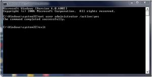

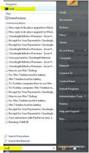

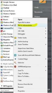

Ok ... attached are screenshots of steps I took to enable built-in administrator account.
Dell's instructions from your link:
Start / Search cmd / right click and run as administrator.
Note in step 2 that I could not run as administrator.
So in step 2b, I right clicked on the Command Prompt I had pinned to the Start Menu so that I could run as adminstrator.
Then I completed in steps 3 & 4.
post-142907-0-75830400-1456034053_thumb.
post-142907-0-57978500-1456034063_thumb.
post-142907-0-31394000-1456034074_thumb.
post-142907-0-97608700-1456034083_thumb.
post-142907-0-30853300-1456034092_thumb.

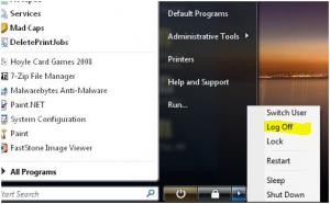

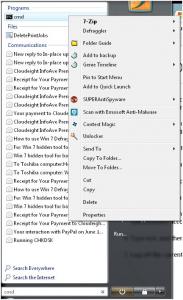

After desktop was prepared in Administrator account I went to Control Panel and made sure UAC was turned on, then logged off.
You said, "Now "Cindy" account should be able to "Run As Administrator" and MBRWhiskey should run normally. Also nothing need be "pinned." If not log off and try the same thing in the "Administrator" account.
I logged back into Cindy account and tried to right click MBRWhiskey to run as administrator form Documents folder. As you can see in #5 I did not get the option to "Run as adminstrator" as you were so sure I would. But, #6, I was able to pin to Start Menu, as before, and get the RUN AS command and also the 7-zip menu options.
You said if it didn't work in Cindy account to go into Administrator account and try the same thing. I did that and nothing has changed. I tried to right cick on mbrwhiskey and got neither the RUN AS command or the 7-zip options menu, #7 .... but once again when I pinned mbrwhiskey to the Start menu, then I was able to right click and get RUN AS and 7-zip options, #8.
I must have gone over my quota for attachments because it will only accept two more, so I deleted 5 & 6 from Cindy account and added the 7 & 8 from Administrator account so that you can see I did do it in that account and it still wouldn't work.

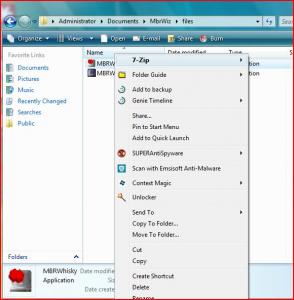

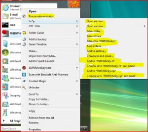

But, Nothing has changed. I logged back into Cindy account and tried to right click MBRWhiskey to run as administrator form Documents folder. As you can see in #6 I did not get the option to "Run as adminstrator" as you were so sure I would. But, I was able to pin to Start Menu and get the RUN AS command and also the 7-zip menu options.

Should I go into the Adminsrator account and from there change the Cindy account to Administrator?
Worth a shot. :unsure: Howevere, since you Administrator account is also hosed, I don't see how it will help (see previous "Security is hosed").
Also, at this point in time, I am NOT prepared to give a Lesson on anything else.
I WILL suggest one last thing -
1-Using the Administrator Account, CREATE a NEW UserID (call it "Test") as an Administrator (remember the "Groups" lesson?) and DO give it a Password (use "Test") and if need be a Hint (use "test").
2-Log Off and go into "Test" account and try ye-olde Right-click. Report back what it does.
Worth a shot. :unsure: Howevere, since you Administrator account is also hosed, I don't see how it will help .

================ I'm going to go ahead and give this
To Allow Access ("see") Hidden Partition.
Run CMD.EXE (you already know how)
Step#1
diskpartselect disk 0select partition 1set id=06 overrideexitexit
Logoff/Reboot
Step#2 - Go to -
Control Panel->Administrative Tools->Computer Management
Select "Disk Management".
Click on the line that lists your Three Partitions (lower right).
Right-Click the First On.
"Change Drive Letters And Paths"
"Add Drive Letter" (any available).
To Remove Access (re-hide it) -
-Perform Step#2 above but THIS time (in last step) REMOVE drive letter (whatever one was assigned).
-Perform Step#1 above but THIS time use "DE" instead of "06".
Easy-peasy.
