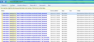

RUSerious Posted March 17, 2014 Posted March 17, 2014 (edited) Still have XP on my boot partition.Win7 installed to an extended partition (same hdd). Both 32 bit.Working with only one win7 account for now -- the admin -- to keep simple as possible.And there is only one account if I log on ' off.In process of transferring apps ' settings to win7.Tried to do reg imports into current user, but not picked up by win7.Tried a theme from MS site, but installed inI:\Users\PC\AppData\Local\Microsoft\Windows\Themesnot in I:\Windows\Resources\ThemesWas having trouble with one app in win7 (not imprtant, will junk it) so did a search on win7 partition and got this bazarr result of redudnent entries -- see pic. And that is just for one error report.This is the kind of junk I would include in a batch file cleaner, but there is obviously something wrong here.This all seems really scitzoid.Did I do something to my win7 install that needs to be fixed?Any clues?Thanks Edited March 17, 2014 by RUSerious

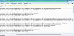

RUSerious Posted March 17, 2014 Author Posted March 17, 2014 Oppened the win7 root (I) and used the search box in upper right corner of that root window.Searched for that app and got the result pictured (details view of search results).Better pic uploaded showing the folder column of details view.I was trying to keep the pic small -- sorry for the lack of detail.I assumed that WER folder is for Windows Error Reporting (WER).Yes all on that volume -- hopefully better pic will show this.Thanks
RUSerious Posted March 17, 2014 Author Posted March 17, 2014 This pic is the left side of some of the same search results:Also attached one of the Report.wer files and they all appear to be the same (if created at same time).Added txt ext to be able to attach here.ThanksReport.wer.txt

jaclaz Posted March 17, 2014 Posted March 17, 2014 (edited) Good .Is it possible that all that "matrioschka" folders are due to some (cannot say which) incompatibility of that app (or it's install routine, or both ) with "links"?Starting with Vista MS started using - often in a senseless way - hard links or junctions that I believe can lead to that sort of "loops".http://en.wikipedia.org/wiki/Special_folderThe data that on Windows 2000 and XP would go to:%USERPROFILE%\Local Settings\Application Datasince Vista should go to:%USERPROFILE%\AppData\Localand to keep compatibility with older programs in Vista and later a folder %USERPROFILE%\Local Settings\Application Data is a junction to %USERPROFILE%\AppData\LocalSee:http://answers.microsoft.com/en-us/windows/forum/windows_7-files/windows-7-infinite-loop-while-using-robocopy/20f32f0c-4cb9-4125-923d-6a57e4d27232http://www.sevenforums.com/tutorials/278262-mklink-create-use-links-windows.htmlhttp://answers.microsoft.com/en-us/windows/forum/windows_7-files/multiple-nested-copies-of-application-data-folder/0617cfb6-dd06-4cb6-874d-0cec97d3a310http://www.sevenforums.com/general-discussion/115149-stop-application-data-folder-replicating.htmlBasically you or the specific app or *something* else is likely to have modified the permissions on that junction and some programs create that "loop", you should be able to solve the issue "manually" or using JunctionBox:http://sourceforge.net/projects/junctionbox/jaclaz Edited March 17, 2014 by jaclaz

jaclaz Posted March 17, 2014 Posted March 17, 2014 Was wondering why I kept getting shuffled from one shortcut to another -- with some needing "ownership".The explanation, though "convoluted" is in this thread:http://answers.microsoft.com/en-us/windows/forum/windows_7-files/multiple-nested-copies-of-application-data-folder/0617cfb6-dd06-4cb6-874d-0cec97d3a310In order to accomplish the proper redirection, you need two junctions:1) A Local Settings junction, that will forward programs going to%userprofile%\Local Settings to the new folder.2) An Application Data junctions *inside of the new folder* that points back on itself, to get programs accessing %userprofile%\LocalSettings\Application Data.If you think about it, it makes sense ... when the program is accessing local settings, it will get forwarded to the folder it needs to be in, however, it is also accessing a folder named Application Data *inside of the correct folder it needs* (since it has already been redirected by the Local Settings junction), so the Application Data junction has to point back on itself for things to function properly.Maybe these explain it better:http://spantechonline.com/wp/?p=69http://wordlinks.wordpress.com/2010/10/30/solved-appdatalocalapplicaton-dataapplication-data-repeating-recursion/http://technet.microsoft.com/en-us/magazine/ee851567.aspxhttp://www.svrops.com/svrops/articles/jpoints.htmjaclaz
