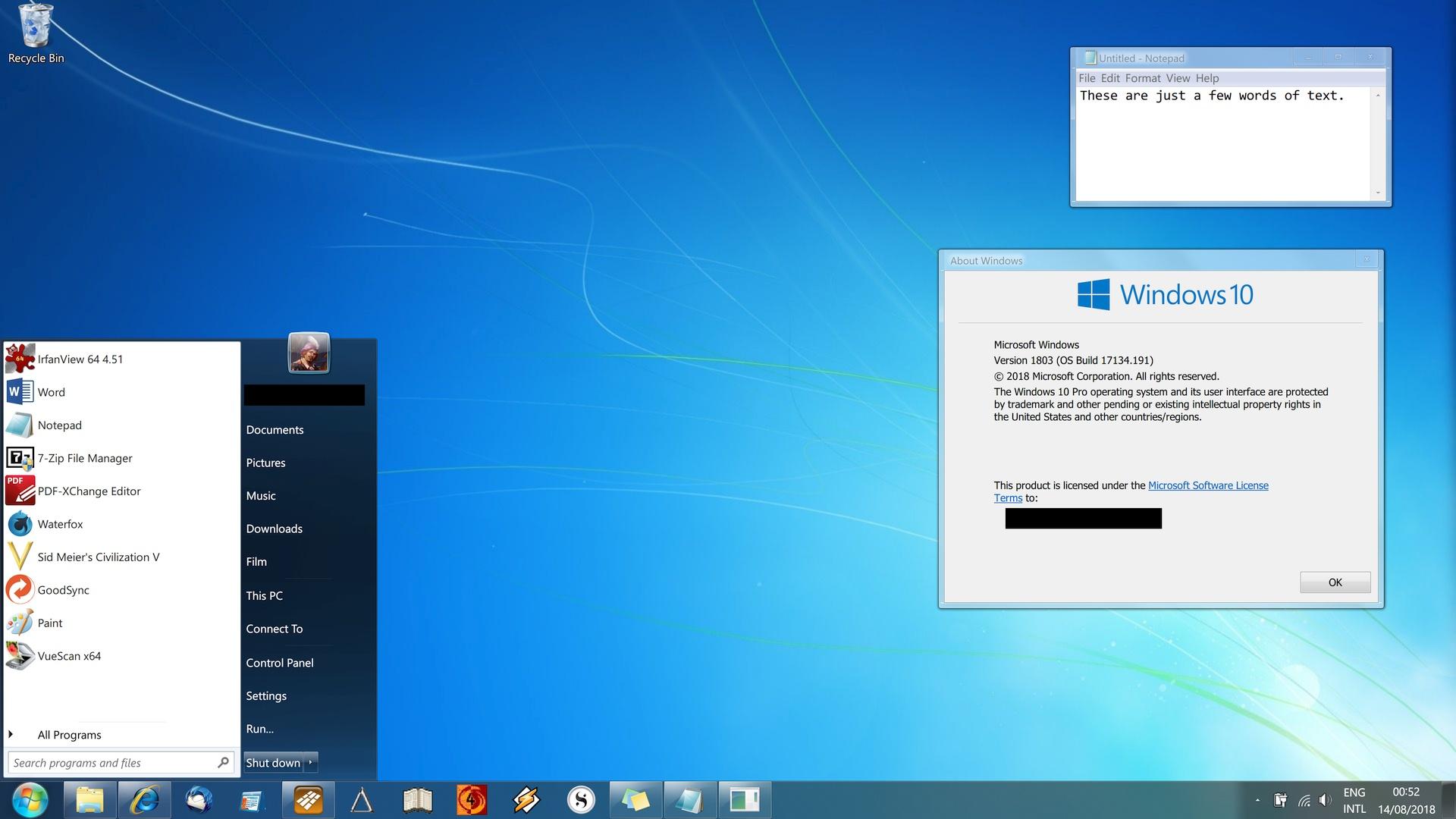

Aethelflaed Posted August 13, 2018 Posted August 13, 2018 (edited) 11 hours ago, Octopuss said: But I can create a theme and use it without problems - I mean otherwise there wouldn't be the "use custom theme" option etc., where I can apply what I previously customized. How do you define third party theme anyway? And is this new to Windows 10? I tried googling around and found pretty much nothing. Yes, Windows 10 supports themes of a sort, without having to patch dll files, or inject other dlls, into your system. Such themes are limited to colours, backgrounds, sounds and mouse cursors, however. Yet the Windows 10 engine is capable of altering much more than just the things just mentioned - buttons, titlebars, scrollbars and the like can all, in principle, be changed. Microsoft doesn't really want you to do this, preferring for its users to work with a mostly uniform interface. This is not surprising, really. The look of its interface helps Microsoft set Windows 10 aside from, for instance, Windows XP, Vista, 7, or 8. This is important from a marketing viewpoint as these OSes are otherwise very similar. Strip away Windows 'app' support, a few security features, and a lot of telemetry, and Windows 10 is not so very different from 7. By using Bigmuscle's dll file, or applying patches to Windows' own dll files, users can 'relax' Microsofts' restrictions, and essentially do what Microsoft does every time it launches a new version of its OS. My own Windows 10 desktop currently looks almost identical to Windows 7, as you can see from the images below (note that I've also changed the icons, and installed a start menu replacer). Others prefer more radical changes - DeviantArt is a good place to start if you are interested in Windows 'skinning'. Do please note that patching Windows dll files can, potentially, be risky, so always make sure that you have proper backups and the means to recover your system should anything go wrong. Edited August 14, 2018 by Aethelflaed Second screenshot. 1

Octopuss Posted August 14, 2018 Posted August 14, 2018 11 hours ago, Aethelflaed said: Yes, Windows 10 supports themes of a sort, without having to patch dll files, or inject other dlls, into your system. Such themes are limited to colours, backgrounds, sounds and mouse cursors, however. Yet the Windows 10 engine is capable of altering much more than just the things just mentioned - buttons, titlebars, scrollbars and the like can all, in principle, be changed. Microsoft doesn't really want you to do this, preferring for its users to work with a mostly uniform interface. This is not surprising, really. The look of its interface helps Microsoft set Windows 10 aside from, for instance, Windows XP, Vista, 7, or 8. This is important from a marketing viewpoint as these OSes are otherwise very similar. Strip away Windows 'app' support, a few security features, and a lot of telemetry, and Windows 10 is not so very different from 7. By using Bigmuscle's dll file, or applying patches to Windows' own dll files, users can 'relax' Microsofts' restrictions, and essentially do what Microsoft does every time it launches a new version of its OS. My own Windows 10 desktop currently looks almost identical to Windows 7, as you can see from the images below (note that I've also changed the icons, and installed a start menu replacer). Others prefer more radical changes - DeviantArt is a good place to start if you are interested in Windows 'skinning'. Do please note that patching Windows dll files can, potentially, be risky, so always make sure that you have proper backups and the means to recover your system should anything go wrong. Ok, I understand now. But it seems like the themes have to be made for the latest version of Windows, don't they? I'd like a Windows 7 like theme, but I am reluctant to try something from 2016 (the only one I found).
Aethelflaed Posted August 14, 2018 Posted August 14, 2018 (edited) Yes, it's best to use one made for the specific version of Windows that you are using. The one you see in my screenshots (esp. that of Notepad) was made by CleoDesktop, and is compatible with Windows 10 v1803. He sells his themes from his own website. EDIT - I am also currently using a Win7 theme atlas, although strictly speaking that isn't necessary (the Cleodesktop theme comes with its own titlebar and window frame). Edited August 14, 2018 by Aethelflaed
