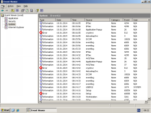

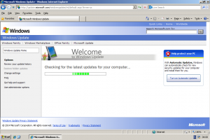

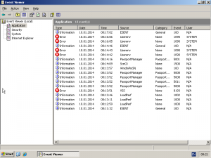

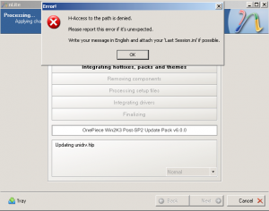

DavidB3 Posted January 10, 2014 Author Posted January 10, 2014 (edited) Well, it doesn't work well with my nLite configuration. Oh, and sorry for the double post.First, it showed me this error:But I deactivated the antivirus and it was gone.But each time I start Windows it says:The event viewer:I made an experiment: from the updates downloaded by WSUS I erased all that could cause problems. After the installation the only problem is that the manual update using IE and update.microsoft.com doesn't work anymore. It's just searching without stopping...You'll notice from Last session.ini that the Automatic update service it's stopped but the manual update should of worked anyway.Last Session.zip Edited January 10, 2014 by DavidB3
Ponch Posted January 10, 2014 Posted January 10, 2014 the only problem is that the manual update using IE and update.microsoft.com doesn't work anymore. It's just searching without stopping...According to one of the last threads in the XP forum, it's a problem caused by Microsoft, not by nLite.

DavidB3 Posted January 11, 2014 Author Posted January 11, 2014 Ok.I tried adding only WindowsUpdateAgent7.6.7600.256.cab containing WUA.exeSame problem:I noticed Wuapi.dll was missing. But if I start directly WUA.exe it says it's already installed.Then I tried an "online" Update Agent script, found on this board. It downloaded and installed WindowsUpdateAgent30-x86-7.6.7600.256-257.exe,This time Wuapi.dll was in System32 and has the appropiate version.But still can't find any updates.Since the problem only appears when I add the updates (downloaded by WSUS) I think there could be one that "breaks" something.Here is the list with all the updates:Addon_DirectX32_9.0c_Runtimes_201006.7zIE8-WindowsServer2003-x86-ENU.exeIE8-WindowsServer2003-KB2898785-x86-ENU.exeIE8-WindowsServer2003-KB2510531-x86-ENU.exewic_x86_enu.exewindows2003-sp2-windowsmedia-kb975558-x86-enu_13e40f38427a55952359bfc5f52b5841ce1b46ba.exewindows-en-us-kb2564958_eac36fe4548b42a26f79b1970de1998c82966bce.exewindowsserver2003.windowsxp-kb963093-x86-enu_c53606bca846117e1cebe7dd9a37251cb84aa41d.exewindowsserver2003-kb914798-x86-enu_5e87472242821046a73c1e1e780ef8d54394c86a.exewindowsserver2003-kb921503-x86-enu_d638c0ab64afec750c3b44af8c6a6354fc4cf778.exewindowsserver2003-kb923561-x86-enu_6a2b494db6b2246388d534bd84ad5dba32eb560b.exewindowsserver2003-kb923810-x86-enu_13e454cf78166c796f0c3d101f2de7d8a1050795.exeWindowsServer2003-KB925876-v2-x86-ENU.exewindowsserver2003-kb925902-v2-x86-custom-enu_b4cb4db21d24bc1042dfe24944962039ff0e1ab3.exewindowsserver2003-kb926122-x86-enu_5f96c923552e5aa513c46ef43048f81717d4e18e.exewindowsserver2003-kb929123-x86-enu_1dc5f603959926665ddd3a8a7493ad509078e2ed.exewindowsserver2003-kb931836-x86-enu_a2a7adf182587f5478e7ed603d77dff03078df6f.exewindowsserver2003-kb931836-x86-enu_a02f15d742e3c547166d976d396f3a0eb5207161.exewindowsserver2003-kb932168-x86-enu_625b655a893a160939efc26243f1e43f5165d0a6.exewindowsserver2003-kb933360-x86-enu_ccfb519db6904a41f157aeb0ae8ae79e8ecd41ab.exewindowsserver2003-kb933854-x86-enu_44ea0a651ebaee22047eda5a5af9e7b5a51080b8.exewindowsserver2003-kb935839-x86-enu_aad4cd3e83103bbc39db7c121ffe2ee208d52f36.exewindowsserver2003-kb935966-x86-enu_7d0a276d0dda36663285c7128b3c5de61805308f.exewindowsserver2003-kb936782-x86-enu_62f505b35c747fd8dbc6a2a8254489810f449f2c.exewindowsserver2003-kb939778-x86-enu_054aac730cc95b6b74e67d8fda749d1523c339c3.exewindowsserver2003-kb941202-x86-enu_ff4efe8f143df8942a37bf32af34effdf2667932.exewindowsserver2003-kb941569-x86-enu_59d158cb9faa84cb039e25ec0b0d5ac9c0a3172a.exewindowsserver2003-kb941672-x86-enu_40822da391ec6911a49b5a34577d082aaf481b8d.exewindowsserver2003-kb942763-x86-enu_563ce7457b2097989e1483eef255b631e0b60ab4.exewindowsserver2003-kb942831-x86-enu_a24e598fc57f07b76413f35c539705d8c2f511a1.exewindowsserver2003-kb943460-x86-enu_cead784ff3fcacd94dcd70997a32af3400938d59.exewindowsserver2003-kb944653-x86-enu_c535f7ca15ef8bbac7d7bbcf5bedda1a76fafd77.exewindowsserver2003-kb946026-x86-enu_e61a1830c2e2c6ebda683a01f1b2f69afa774fc9.exewindowsserver2003-kb948590-x86-enu_8aedf88dfe8ac26cb7d6608108305b81e84dc307.exewindowsserver2003-kb950762-x86-enu_7bd6217633e3ea351ba4d37bef12a2e4e83f6828.exewindowsserver2003-kb950974-x86-enu_5fade4aa44fc891306ddb5bbfd725728df36f932.exewindowsserver2003-kb951072-v2-x86-enu_604dd60e9146d5b384408f58f518389f8fab01c8.exewindowsserver2003-kb952004-x86-enu_a21ae7e539f5b95e5a0189920919a73b848a7f5a.exewindowsserver2003-kb952069-x86-enu_eccaac25b009ffe40d6774cc4d30de458030263d.exewindowsserver2003-kb952954-x86-enu_74b5fcde7dac1ba40f6a354f68b48c0c3aa7aed2.exewindowsserver2003-kb953155-x86-enu_7a1a7238d6cec7a98e779aad1644d3c1b9b63e56.exewindowsserver2003-kb954155-x86-enu_3f7c8db948f70f770bea3e48c5aaa4de299d1524.exewindowsserver2003-kb955839-x86-enu_460a0952a82cbd07dfbac6d6331bb8962ca6baf3.exewindowsserver2003-kb956572-x86-enu_0374cf6ceb272b04d295e274153e29d0e8159c9d.exewindowsserver2003-kb956744-x86-enu_83d79816052efde748645ffebe6bd80751dd1656.exewindowsserver2003-kb956844-x86-enu_cef55a0f6292ff278b2c61692488ee7ba6861cf9.exewindowsserver2003-kb958469-x86-enu_f5012348d3686b222f442dd7f6dcc55c94b7440a.exewindowsserver2003-kb959426-x86-enu_fc4b7de9e7d28143301f458cd5e67165a57cf7f7.exewindowsserver2003-kb960803-x86-enu_f45b6d73e5cf234dddd17339766e63e96fbd8ae0.exewindowsserver2003-kb960859-x86-enu_5bcdb68ab970ad24b76461d466893615a6795aa5.exewindowsserver2003-kb967723-x86-enu_e4016e0fe84b55c83bbd3ac8d9360eb5c102dbef.exeWindowsServer2003-KB968930-x86-ENG.exewindowsserver2003-kb969059-x86-enu_1631c387d7b90bdb97d7fbd495150592965b835e.exewindowsserver2003-kb970483-x86-enu_7255fd03d0655562f1460fdd6b9c0df19c0e356a.exewindowsserver2003-kb970653-v3-x86-enu_d3a5f2fad7b85c2055ca9ee1369b46b6671a5b8d.exewindowsserver2003-kb971032-x86-enu_eb464fc452ea3175c257cadca9c1b96a64c2b858.exewindowsserver2003-kb971657-x86-enu_e6fe894a7b5d49759cd1af5fed0668c85783a7b7.exewindowsserver2003-kb971726-x86-enu_1e18aaaa8625948195713aa368ac6d01ad559c81.exewindowsserver2003-kb972270-x86-enu_f5c51598d9756a4ad36a6367bb80c074436cbf74.exewindowsserver2003-kb972554-x86-enu_1bf0c8fabc96bebb3b80d3b3013019946399c0da.exewindowsserver2003-kb973507-x86-enu_2d3da9a00d3da7d28b24b768168b258a2db25001.exewindowsserver2003-kb973540-x86-enu_116f9b589f91de8c43c3075b85c0f1e57dd4be8c.exewindowsserver2003-kb973815-x86-enu_606124c5bf0341bef494034b5820eb96786b45e3.exewindowsserver2003-kb973869-x86-enu_3673f6d13c5715abbaef622993ab329e4c1d36a0.exewindowsserver2003-kb973904-x86-enu_75915ea987919e08ea050a775677a33de3829073.exewindowsserver2003-kb974112-x86-enu_5c7bf54e1a088db171808236da5e8a8931a555de.exewindowsserver2003-kb974318-x86-enu_eddf08b15b88d06bcff936ed0b5ac6727911d0f3.exewindowsserver2003-kb974392-x86-enu_643c62dfab9df7a56cd57affd898c2c8ca3e4218.exewindowsserver2003-kb974571-x86-enu_aa20f7cde8c64ec0ddb784fc623f471918d75ab3.exewindowsserver2003-kb975025-x86-enu_bf83b5589d6430c621ffa1f8586b45d22f7d5cfc.exewindowsserver2003-kb975254-x86-enu_6f2929e58e8e30bd34bac82a9cf1f957467a4cc3.exewindowsserver2003-kb975560-x86-enu_4db4bfe7c1574f3679c97a1fd12ca3c0745da583.exewindowsserver2003-kb975713-x86-enu_a1ea0c67a08b6abe3931f949688298f6be0e3c59.exewindowsserver2003-kb976098-v2-x86-enu_37c7bdba2ff731a75c57c9379314a0f0d3f0b3ca.exewindowsserver2003-kb976323-x86-enu_9be04b5cdf31afe452c5c7da8c750eb2aa3aa3be.exewindowsserver2003-kb977816-x86-enu_2d4d363e8f9c91933f2393a92ab0be618e331392.exewindowsserver2003-kb977914-x86-enu_961941f911abad3d7a28a876b7d2afcca743c52e.exewindowsserver2003-kb978338-x86-enu_fa9f4909f133aae43c3bdf01fbd7c1caf0a50dfb.exewindowsserver2003-kb978542-x86-enu_100d1208544395fb39a688b6373c520f90254af6.exewindowsserver2003-kb978695-x86-enu_a2bd6e0ca906b9e0c73f47bf28ef2c6c00dc6115.exewindowsserver2003-kb978706-x86-enu_8f3ca920a4d6bb39effec9b9df801db041e589ef.exewindowsserver2003-kb979306-x86-enu_1ea9c41391480aac3390730713a6eb09c565fdb4.exewindowsserver2003-kb979309-x86-enu_318f9b7a5d0e2faec4e95835a23b519ce22e8b7d.exewindowsserver2003-kb979482-x86-enu_7168d27f2a3949b83a494d724b05812ac559a24c.exewindowsserver2003-kb979687-x86-enu_06ca4443600844071c9a483d8bc31850c4936d2b.exewindowsserver2003-kb979907-x86-enu_a1fa5fe6f871f047fb2f3d1e4057e811d92593a2.exewindowsserver2003-kb980232-x86-enu_632552850d4774817c9d8a0f31d061078eb5642c.exewindowsserver2003-kb981793-x86-enu_859b6dbf787ae94359329cfde512b7e9d82129a2.exewindowsserver2003-kb982132-x86-enu_7824d40f1ec8d116420e9ad4ec337fc7a346fdf9.exewindowsserver2003-kb982666-x86-enu_e39d3224d5e2591f57a753ee896ead71e3fdb03d.exewindowsserver2003-kb2115168-x86-enu_91332b25fed8bdd262888108f82ea1a771fb2d9c.exewindowsserver2003-kb2124261-x86-enu_977f17f71c3fcd80920e73476d842a04fb5731f4.exewindowsserver2003-kb2158563-x86-enu_2c867eef50b3bcf9b666bd3aa6d60475e8be5857.exewindowsserver2003-kb2229593-x86-enu_fa2f619ab2c59715e80115b502fc5e8d13cccb76.exewindowsserver2003-kb2347290-x86-enu_056f93a5449496c37f49a46a49c85ac52ca27672.exewindowsserver2003-kb2378111-x86-enu_7a42eee2b465640eb26416964cd2b0c3e7bc1dfd.exewindowsserver2003-kb2387149-x86-enu_f1ebe74f098e17dc4726d4c581bb8be5bd100cc6.exewindowsserver2003-kb2393802-x86-enu_a8e318bb1f72d9c9b9f053f8caafdc88bc9bbd7e.exewindowsserver2003-kb2419635-x86-enu_69bed4ff1d1720f1fa255badadc46a1075666f6e.exewindowsserver2003-kb2423089-x86-enu_302fffe93b3b43bc04f722b1c34fb7a38fb049ef.exewindowsserver2003-kb2440591-x86-enu_9afeb6e7b4469a909df4b0cad2d76fdd26b06e0c.exewindowsserver2003-kb2443105-x86-enu_6b3912563438c46a03f9089b4edcd4771940c654.exewindowsserver2003-kb2443685-x86-enu_636191ef5aa2210f4b3f7567059f0dcba2508620.exewindowsserver2003-kb2467659-x86-enu_f265b129f06eadc62f247b23c6e609e9e669003a.exewindowsserver2003-kb2476490-x86-enu_c14b9655fccd5002ede28be4bbb14b572e41e392.exewindowsserver2003-kb2478953-x86-enu_c5ac3e0056fa2ef84a17ce1549186899e0169450.exewindowsserver2003-kb2478960-x86-enu_f06003d2076cf8b99214a269aecbdef842b3dc09.exewindowsserver2003-kb2478971-x86-enu_5881be2c21530dfc925ca422198a180233415bbe.exewindowsserver2003-kb2481109-x86-enu_a13bb02e17b122f0d646d563fe136451d5a83408.exewindowsserver2003-kb2483185-x86-enu_d2437dfc1c5e9e909d25ace627bf4346e719ffbd.exewindowsserver2003-kb2483619-x86-enu_82cc3810c1451a9fe240ce0f181db6f3aa109660.exewindowsserver2003-kb2485663-x86-enu_025bc09e90720e9c91545655e475ac247d97198d.exewindowsserver2003-kb2491683-x86-enu_db35273712dcab9d48c46ca40c17d127bf6b876a.exewindowsserver2003-kb2497640-x86-enu_cece602445a64ee90bb07d49a1b59a429e9933f9.exewindowsserver2003-kb2506212-x86-enu_4492bc520d8484324154ccd2fae8d275d0142560.exewindowsserver2003-kb2507938-x86-enu_5b335af8fe49f69c5acbdb4125bbdce0f001a11b.exewindowsserver2003-kb2508429-x86-enu_1d4ff4ef7163f06d580e7fbc94cc222bafd0733f.exewindowsserver2003-kb2509553-x86-enu_4906a643af6eb03b718432ad726b19343de3bc84.exewindowsserver2003-kb2510581-x86-enu_a8f7367ddae1c43aa3193d4077dfed724634e094.exewindowsserver2003-kb2510587-x86-enu_ee94e9a4208068b43c1871cd273666a208d65ee2.exewindowsserver2003-kb2518295-x86-enu_57e02066d3b0c192e74cbdf90d9ec485ff088e13.exewindowsserver2003-kb2535512-x86-enu_418fe36d5b539af61508681b14e1f13ee2cfac27.exewindowsserver2003-kb2536276-v2-x86-enu_13b985a39c5f77f572de773d89a0f2f969a6f488.exewindowsserver2003-kb2544893-v2-x86-enu_b7164f566084413267f89097e08c7737d5f1f202.exewindowsserver2003-kb2555917-x86-enu_1dfd6ef48e23a4fd8ae15597656a45eb21296f75.exewindowsserver2003-kb2566454-x86-enu_085ed925169860cf4b3881ffd00a7816968923b5.exewindowsserver2003-kb2570791-x86-enu_c5a5332fac7c82571643858c0e4a2fdb75240e06.exewindowsserver2003-kb2570947-x86-enu_45d05a540e41debfaae4edf294147a30ecbd2f8d.exewindowsserver2003-kb2571621-x86-enu_3ebc866af3b70b1b8a4775cb3020dc46ac0db366.exewindowsserver2003-kb2584146-x86-enu_ed8a80ffdf6be5749ad6e276c5968f0ad136b5c9.exewindowsserver2003-kb2598479-x86-enu_0bd96c4eb2322c990129c7b0cfea2f4035bbc065.exewindowsserver2003-kb2603381-x86-enu_e338403c8aab7f7d205a80ceb4211417944c7955.exewindowsserver2003-kb2620712-x86-enu_4492e86c3c7f7da16144b67fcd1be063b4adcc2d.exewindowsserver2003-kb2631813-x86-enu_f4cd1a3faa3a7310e9fdbf90566e915d8d27fbb6.exewindowsserver2003-kb2633952-v2-x86-enu_e51b8197c2e8a503acac1b4ed046df52ccee2b66.exewindowsserver2003-kb2638806-x86-enu_dd96782ed8f0c84a7b58e05c3eabbcb120be9d99.exewindowsserver2003-kb2641653-x86-enu_5e9e426803e2e4e3e71c4a3b9b686e5c648239e7.exewindowsserver2003-kb2644615-x86-enu_7ae09552c5fa9036e4c0fd9907b1027aa849c4b2.exewindowsserver2003-kb2645640-x86-enu_9e50f913aed8980b4f9a894b7f7aab644a5c8654.exewindowsserver2003-kb2647170-x86-enu_e2fc58e379076b06263f72fdff1602570fcb9d9f.exewindowsserver2003-kb2653956-x86-enu_3d7ad78e199a78b26bcf55952abbf9230ca5657a.exewindowsserver2003-kb2655992-x86-enu_581e42744d78ea215f6502b6462fe6a1a959b188.exewindowsserver2003-kb2656358-x86-enu_4c9b66c6e75195670c91ccf15a68a0302343a44d.exewindowsserver2003-kb2659262-x86-enu_7b19add0182d79c514ec394dac2f7ffde0619c7c.exewindowsserver2003-kb2676562-x86-enu_ec21d290d8b4b2d5fb0cffee2d1de28be27c8809.exewindowsserver2003-kb2685939-x86-enu_e2d17120cbc97e36b89050c751c1a5830bf048e1.exewindowsserver2003-kb2686509-x86-enu_ac2ef5c8c28e533f07959011c6c10cf84e314ab3.exewindowsserver2003-kb2691442-x86-enu_2a3004e7271c1b7d8a9576496086f7f50c2256f7.exewindowsserver2003-kb2698032-x86-enu_b73ee0b5157f524c2599d40297104a7735394e58.exewindowsserver2003-kb2698365-x86-enu_6ef77f3cdd181e4bd2c0c55a5086ffb753801a3f.exewindowsserver2003-kb2705219-v2-x86-enu_03e7bb6f779862cbe5bc8ebb9bcc85a1e936688b.exewindowsserver2003-kb2712808-x86-enu_8b521a0a1a891b6f05973a419a7b34de2d16ef16.exewindowsserver2003-kb2719985-x86-enu_d88236dcbba74b1b29536e91555168d9dfe0b758.exewindowsserver2003-kb2727528-x86-enu_436d67e9be1032d344666edb472a3ead9ef4f371.exewindowsserver2003-kb2742604-x86-enu_489ec592ccfb803a789f94d783c0167ede788966.exewindowsserver2003-kb2756822-x86-enu_2defac1e1f7147d388f323e80983f694f253b1b4.exewindowsserver2003-kb2758857-x86-enu_192870771a23118f734c1a1288df23da1ff35eee.exewindowsserver2003-kb2770660-x86-enu_2bb394a8d2224b873614b3c74ec47e32aaf29680.exewindowsserver2003-kb2772930-x86-enu_156018f5a2ae5b1188b5d6fdad015f49a06eb1ec.exewindowsserver2003-kb2779562-x86-enu_54ae30d9a9d188a58f566d85d60702bf1503fda6.exewindowsserver2003-kb2780091-x86-enu_ff47a4bc1827cb3f67cf6e92f035fbaf299d440a.exewindowsserver2003-kb2801109-x86-enu_a27bfcb0307ef62ff961c60ed47f14a404073d72.exewindowsserver2003-kb2803821-v2-x86-enu_5cb3a6deedb3aa6584f8512e172e1d7503018634.exewindowsserver2003-kb2807986-x86-enu_b00e8fd97271d1e512774330e89a5790983c650c.exewindowsserver2003-kb2813345-x86-enu_2a461432292ab5592d9e919dddc4389863aa9eb6.exewindowsserver2003-kb2820917-x86-enu_9c60120102d679668e9ac6bd7bf423f08210fa6c.exewindowsserver2003-kb2833949-x86-enu_87fc49f9120ec10043349dd7c5ff0a3c6b692e01.exewindowsserver2003-kb2834886-x86-enu_c23999154b62ed208830438de3bc517daf40246d.exewindowsserver2003-kb2845187-x86-enu_e89450833d07d0ff56d9b4cd5795cbafa998e53e.exewindowsserver2003-kb2847311-x86-enu_39ed5fb0ac8d045681dbe4f800cea7bd1b3cee17.exewindowsserver2003-kb2850869-x86-enu_50164a48c2f846ffcf7ef489c4fe6d2b339f8a46.exewindowsserver2003-kb2859537-x86-enu_350bb4e34d0d40f2cba478ba2cf1e12d30119672.exewindowsserver2003-kb2862152-x86-enu_8d96f688b35efa32eec1b05c92a8422d304e972d.exewindowsserver2003-kb2862330-x86-enu_717b0e64e2d4b89c1655a5cb333d3e51ad3f702b.exewindowsserver2003-kb2862335-x86-enu_a6714a1d9236add87da849ec4385ac399fb386f2.exewindowsserver2003-kb2863058-x86-enu_9851a499eb7dd2a13ac7b7e4bba9584357b0d5dc.exewindowsserver2003-kb2864058-x86-enu_40cf9fa6d330c4edd66df1937411b16009cecf49.exewindowsserver2003-kb2864063-x86-enu_8920ec2db9884abfaa42d0b6686939cce1c3679e.exewindowsserver2003-kb2868038-x86-enu_f163027eee07194163dfd1f46ba9dff1bba96c22.exewindowsserver2003-kb2868626-x86-enu_e08def74230cef9e26364a61651db3b711fd6b1b.exewindowsserver2003-kb2868846-x86-enu_d346335422493dd5ff731fdc6c84f94cdd5f1dba.exewindowsserver2003-kb2876217-x86-enu_8731271c94f391a2b1771402e0385cd1a8a01fdb.exewindowsserver2003-kb2876331-x86-enu_b70297dcd4359a600f2c5aa1a8d47e75858aa4a6.exewindowsserver2003-kb2884256-x86-enu_0993aa1ce79896621eba65dc70d48dd546ac9350.exewindowsserver2003-kb2888505-x86-enu_8cc6171967ff649b40536122ef7f27303fb10762.exewindowsserver2003-kb2892075-x86-enu_e54cf9059a2fd182560871e2a117cd3bc52b892d.exewindowsserver2003-kb2892076-x86-enu_bb30c756460250fc2dd8dea86628b41519908d8c.exewindowsserver2003-kb2893294-x86-enu_66af7c56915fa7859494dab7da995c6407e9da24.exewindowsserver2003-kb2893984-x86-enu_26ad657442fe22f46a7f8c9363fe019716dff045.exewindowsserver2003-kb2898715-x86-enu_051eb5ad7afde9ef99003986660539f3afd222fd.exewindowsserver2003-kb2898785-x86-enu_a816e1b0db4f6036ab7d4b3d325bfaa53459e4e4.exewindowsserver2003-kb2900986-x86-enu_4058b2d3d54c335d2f6247f2e0b7caad99903397.exewindowsserver2003-kb2904266-x86-enu_0207e36c47f946d2dea6f3b06a224ff054642184.exewindowsserver2003-windowsmedia-kb2845142-x86-enu_0ace94c09bfab15410db3a15ffa42370891266de.exeWindowsUpdateAgent7.6.7600.256.cab
submix8c Posted January 12, 2014 Posted January 12, 2014 1 - I tried adding only WindowsUpdateAgent7.6.7600.256.cab containing WUA.exe<snip>I noticed Wuapi.dll was missing. But if I start directly WUA.exe it says it's already installed.2 - Then I tried an "online" Update Agent script, found on this board. It downloaded and installed WindowsUpdateAgent30-x86-7.6.7600.256-257.exe,This time Wuapi.dll was in System32 and has the appropiate version.But still can't find any updates.3 - Since the problem only appears when I add the updates (downloaded by WSUS) <snip>1 - How did you obtain it? Using the -X- UDC Script? The file is inside WUA.EXE (open it with 7-Zip or whatever to see it) so it can't be "missing".2 - What "online" one? I don't remember that one... link, please.3a - Is your "problem" that it continues to run (as the screenshot implies) without end (patience for it to COMPLETE) or is it that it finds NO UPDATES upon completion?3b - You said by WSUS? Can you explain (you mean the Offline one)? ALL files come from MS' WSUS Servers.3c - IF no Updates showed - IF it completed, then what you Integrated must be ALL that MS sees as "needed".Please respond because you're not being clear ("Need Input").
DavidB3 Posted January 13, 2014 Author Posted January 13, 2014 (edited) 1 - How did you obtain it? Using the -X- UDC Script? The file is inside WUA.EXE (open it with 7-Zip or whatever to see it) so it can't be "missing".Yes, I obtained it using the -X- UDC Script. Yes, the file is inside WUA.exe and no, it is not in the System32 folder after install.2 - What "online" one? I don't remember that one... link, please.This one. Sorry my english, I named it "online" because it downloads it from internet.But even if after using it the wuapi.dll file is copied in the System32 folder, I have exactly the same problem, no difference.3a - Is your "problem" that it continues to run (as the screenshot implies) without end (patience for it to COMPLETE) or is it that it finds NO UPDATES upon completion?Even after a few hours it still not find anything, just keep searching over and over. When it works it takes only a few min to find them.3b - You said by WSUS? Can you explain (you mean the Offline one)? ALL files come from MS' WSUS Servers.Yes.3c - IF no Updates showed - IF it completed, then what you Integrated must be ALL that MS sees as "needed".That's the problem like I said it doesn't complete. Edited January 13, 2014 by DavidB3
