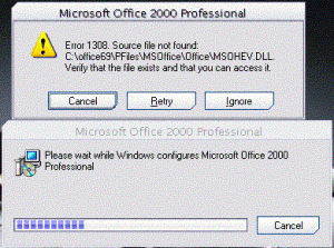

buckeyeXP Posted June 14, 2004 Author Share Posted June 14, 2004 OK here it is... Shrink Office development for different languages.ONLY THE ENGLISH AND SPANISH SETTINGS ARE HARD CODED INTO IT.Here is what you do...1.) Run office shrink click "NO" on the option to use the previous setup file.2.) enter you language. (If it is not listed let me know and i will try to add it)3.) It should get stuck at an error message. That looks like the attached picture.4.) Open the shrink.ini file:[Language]lang=Englishdir=1033retry=&Retrytitle=Microsoft Officeerror=ErrorChange the retry to the text on the middle button... the equivelant of "retry" in the language that you have chosen. be sure to leave the "&" infront of the wordif the word for error is different than error then change thatChange the title to the title of the error window. the first two words are sufficient.5.) Rerun office shrink and choose to keep the ini settings. It should work.(of corse if it dosent send me the log and a screenshot would be helpful also)6.) If it works tell me the settings of just send me the office.log or shrink.ini so i can hard code them into the program. Link to comment Share on other sites More sharing options...
