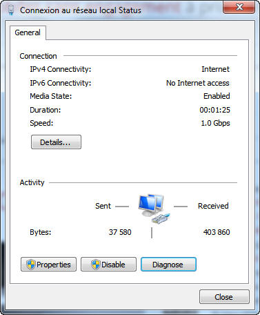

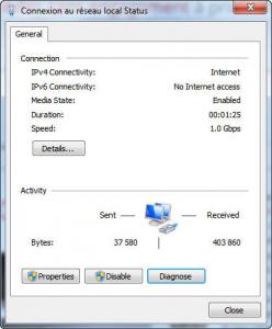

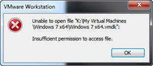

coucou Posted June 26, 2013 Posted June 26, 2013 (edited) Hello,Last week, I installed my unattended Win7 64 bits. It works like a charm TNX to MSZFN help and supports However, I've 2 more tweaks to configure. 1) Although I've installed a RegTweaks and SetACL (see here bellow attached file), still I've not all the rights (see here bellow attached image) to Run, Copy, Move... to "Run as Admin" or right-click "Take Ownership". Is anyhow to get the full rights always?2) My machine is a desktop, I'm not Wifi connected, I'm cable network connected (higher speed). As time to time I've to be NOT connected. The network connexion properties has no "Enable" button (see here bellow attached image) , so, I've to physically disconnect and connect the cable from my machine. Is anyhow to add a connexion buttons like the Wifi?RegardsMyTweaks_64.regSetACL_full.cmd Edited June 26, 2013 by coucou
jaclaz Posted June 28, 2013 Posted June 28, 2013 2) My machine is a desktop, I'm not Wifi connected, I'm cable network connected (higher speed). As time to time I've to be NOT connected. The network connexion properties has no "Enable" button (see here bellow attached image) , so, I've to physically disconnect and connect the cable from my machine. Is anyhow to add a connexion buttons like the Wifi?What happens when you click on the "Disable" button in the center of the window you posted a screenshot?It vanishes in thin airThe text in it changes by sheer magic into "Enable"Something else (please specify)What happens when right clicking on the connection entry?http://www.cavsi.com/questionsanswers/how-to-enable-or-disable-a-network-adapter/jaclaz
DosProbie Posted June 28, 2013 Posted June 28, 2013 On my Unattended installs I always use a "Autounattend.xml" file and setup the computer as the Default Administrator,under the OOBE section, that way you always have full rights and avoid the run as admin problems..I have a batch filewhere you can toggle your connection on/off, if you want I can post it for you..DP
coucou Posted June 28, 2013 Author Posted June 28, 2013 (edited) TNX jaclaz and DosProbie for yr help 1) To have full unrestricted access rights and permission on my computer, I've enabled the Built-in Elevated Administrator Account by uncheck the "Account is disabled" and "Password never expires" box in "Administrator Properties".And turned Off UAC notifications completely to "Never notify" as the here bellow reg[HKEY_LOCAL_MACHINE\SOFTWARE\Microsoft\Windows\CurrentVersion\Policies\System]"ConsentPromptBehaviorAdmin"=dword:00000000"EnableLUA"=dword:00000000"PromptOnSecureDesktop"=dword:00000000Although the here above addon, still the machine ask for Run, Copy, Move... to "as Admin" or right-click "Take Ownership". Is it because I'm using 64-bit IE10 ?2). Believe me or not I've tested what jaclaz advise here above. It wouldn't works I tested it right now... it works like a charm However, It is possible to add "Manage network connections" shortcuts to Start/"Connect to" as WinXP?Kind regards Edited June 28, 2013 by coucou

coucou Posted July 1, 2013 Author Posted July 1, 2013 (edited) Hi,I finally caught the troublemaker: Loaris Trojan Remover.It scan the machine on every startup, it detect the UAC as an Hijack and fix it (see here bellow image). I don't know how to exclude files, folders, registry to be ignored when Loaris scan. Edited July 1, 2013 by coucou
