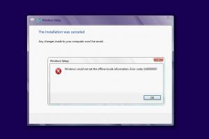

windows could not set the offline locale information
Thanks but I don't really understand "0x80FF0000 happens when applying OS-image through setup.exe, if user-profile has been redirected during initial unattended install"
I didn't think was redirecting it in my xml?
I think it means installing Windows via Setup.exe. Are you installing it this way, or with DISM?
Yes installing via setup.exe from the sources dir, UA using an iso

Thinking the original DVD source being an en-GB UI Lang is causing the problem!! I have never here in Aus ever purchased a en-GB sourced OS previously
Always had en-US ones & never experienced this problem before.
think you hit the nail on the head. definitely could cause problems if language is not localized in the image

I read on MS one needs to remove an unused Lang pack first before installing the preferred Lang pack.
Have removed the original offline en-GB pack using Dism then installing en-US before applying any updates. I check &change lang preference & timezones using "Dism /Image:C:\zmountdir /Get-Intl"
Dism reports all was successful on a virgin image & it still causes this problem on install.

Are you running this from iso or dvd?
early on you got this
2013-05-11 06:40:59, Warning    [0x060582] IBS    SetSetupKeyboardLayout:Failed to set the key board layout to [en-US]
2013-05-11 06:40:59, Warning [0x060577] IBS Callback_Locale_SetSetupKeyboardLayout:An error occurred trying to set the key board layout
2013-05-11 06:40:59, Info [0x0a018c] UI Setup UI language is set to en-US.
2013-05-11 06:40:59, Warning UI CLanguages::v_InitLanguage - Failed to load en-US resources with error 2. Will load fallback binaries
Then later missing files like image was a multiple language ad the files are missing.
Didn't do any removing did you with any program?

Only removed en-gb & added en-us lang pack with dism.
Don't think you can do that, a language has to be localized and adding language pack does not fix this on dvd sources. You would need en-us dvd
Microsoft-Windows-Client-LanguagePack-Package~31bf3856ad364e35~amd64~en-US~6.2.9200.16384 | Installed | Language Pack
There may be fixes some where but I don't know what they are.
Might add the us without removing gb and specify that as language then use en-gb as UILanguageFallback

Bloody hell this is so frustrating! I called in my local store & asked about theses discs being en-gb & the guy mentioned there all the same now here in Aus. Previously Lang was always en-us on our discs!
So Max your saying I run with en-gb lang & just change setting with this "Dism /image:C:\W8Prox64\sources\install.wim /Set-UILangFallBack:en-GB"?
