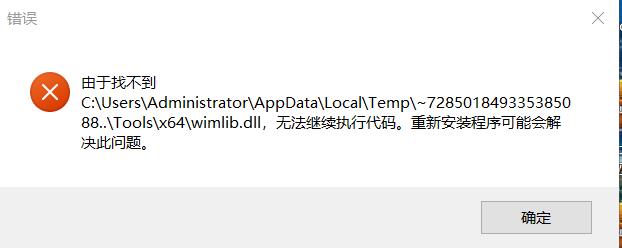

wuliyen Posted February 17, 2024 Posted February 17, 2024 Single file runtime version,5.34 error,5.33 normal
JFX Posted February 18, 2024 Author Posted February 18, 2024 That path is invalid, some API's will misunderstand "..\Tools" to be the parent directory. I doubt you could even open that folder in windows explorer.
