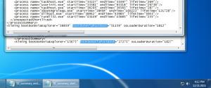

Thank you for this, now my pc boots just 19 seconds :w00t: , which is extremely good for a HDD. :thumbup
This is screenshot comparing boot times before and after,
In case the above link doesn't work, I have attached a Image file with this post.

Edit : I don't know why the After Summary has 27 seconds, Infact my PC boots in 19-20 seconds only. :angel

@4Dialga2
your Windows boots in 17.3s. Substract 10s (idle detection time) from the value BootDoneViaPostBoot or add the value of postBootDisturbance to bootDoneViaExplorer to see the boot time.
Edited by MagicAndre1981
