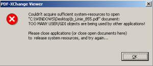

schwups Posted September 27, 2011 Posted September 27, 2011 I can not open pdf files in the latest version 2.5.198 of the PDF XChangeViewer. Following error message appears:
rainyd Posted September 27, 2011 Posted September 27, 2011 I've got similar message with latest version.You haven't such a problem with previous one?
schwups Posted September 27, 2011 Posted September 27, 2011 I've got similar message with latest version.You haven't such a problem with previous one?No, I can open pdf files with previous version 2.5.197.
Windashnet Posted September 27, 2011 Posted September 27, 2011 I can not open pdf files in the latest version 2.5.198 of the PDF XChangeViewer. Following error message appears:Hey just a thought here but have you tried shutting off other apps, including tray apps like the message suggests?Also have you tried updating direct x or using a different video card or different drivers?

schwups Posted September 29, 2011 Posted September 29, 2011 I can not open pdf files in the latest version 2.5.198 of the PDF XChangeViewer. Following error message appears:Hey just a thought here but have you tried shutting off other apps, including tray apps like the message suggests?Also have you tried updating direct x or using a different video card or different drivers?Shutting down apps doesn't change anything. Version 2.5.197 works. Versions 2.5.198 and 2.5.199 don't open the pdf files.
