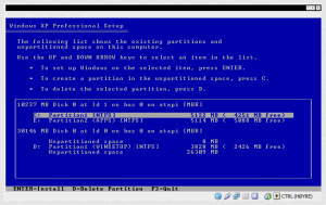

tordenflesk Posted July 12, 2013 Posted July 12, 2013 (edited) How do I change the driveletter of the USB-drive?My nLite'd install uses D: for \Program Files etc. These get put on the USB currently.After a bit of research. Is this due to the way you boot USB in VirtualBox, and setup not seeing it correctly? migrate.inf etc.EDIT: Yup, that seems to have been it. I decided to not be lazy and restart my machine and boot on the "real" hardware. The Drive showed up as W: Edited July 13, 2013 by tordenflesk
ilko_t Posted July 13, 2013 Author Posted July 13, 2013 Is this due to the way you boot USB in VirtualBox, and setup not seeing it correctly? migrate.inf etc.Migrate.inf, which is responsible for the drive letters at text mode, was made for the removable USB disk which was being prepared.VirtualBox emulates and boots USB drives as fixed disks.If you were using USB fixed(hard) disk , I guess drive letters would remain as expected.You may test in VMWare Player, boot from a PLoP CD, connect the USB disk to the virtual machine, select boot from USB in PLoP. This is as close as possible to real USB boot. There is also BIOS for QEMU which also supports USB boot.
