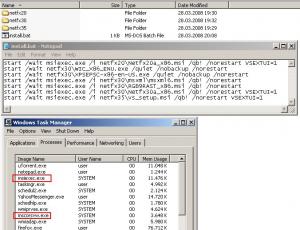

It seems there is a problem with mine: after all the progress bars dissapear, msiexec.exe and mscorsvw.exe are still running in background. I have an image with the batch script and the task manager.
In the previous topic, you said yours is 39.6 MB. Are there files that I keep and are unnecessary?
59.8 MB is enormous. The uncompressed folder has 167 MB. What kind of repack did you use? I don't know which files are unnecessary. But I'am sure that you can cut down about 60-70 MB from uncompressed size if you don't use .NET platform to build some applications. It's normally that after installation of a program packed in msi format, msiexec service will continue to run in background.
