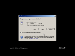

Hey all, I'm working on my 3rd unattended HFSLIP'ed rig. This time, I'm shooting for a multi-boot DVD with 2kPRO and both XP's. I'm trying to follow the directions at http://flyakite.msfnhosting.com, which everyone seems to point to. This setup is very similar to what's described at http://gosh.msfnhosting.com.
After HFSLIP, 2kPRO works fine on a CD by itself, but if I prepare it for multiboot using the instructions on flyakite, setup thinks it's an upgrade version, though my SETUPP.INI disagrees. So, rather than fighting this battle, I decided to let 2kPRO have \I386.
Now, I'm preparing XP Home for multiboot. Everything is working great, except the OOBE on first boot:
If I click Open, IE comes up with a blank window. Either way, OOBE never comes up, and I have to reset the machine. On 2nd boot, RunOnceEx runs as expected, Windows is launched with default user information (owner), and IE is unable to load any HTML page, and HTA files also will not run. Here's what happens when I launch IE:
Here's my WINNT.SIF, which has worked flawless on my last 3 semi-unattended CDs. I'm sure I'm missing something, but...
