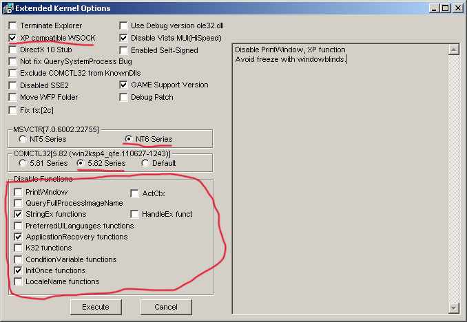

  2. Seems like the crash on Mypal68 is MSVC runtime related, on 2000 + BWC EK if installed using the default settings Mypal68 doesn't launch and crashes after loading CONCRT140 (similar to 9x on DW and FineSSE logs with -lf switch) but this can be fixed by either spoofing the app to XP or reinstalling the extended kernel with NT6 functions enabled. I guess FineSSE v32 might show something similar to that but I could be wrong, that clears out the reason why Mypal68 uses NT6+ functions. Update: I disabled Kexvista and ran Mypal68, looks like it crashes on MSVCP140 instead WATSON22.WLG
