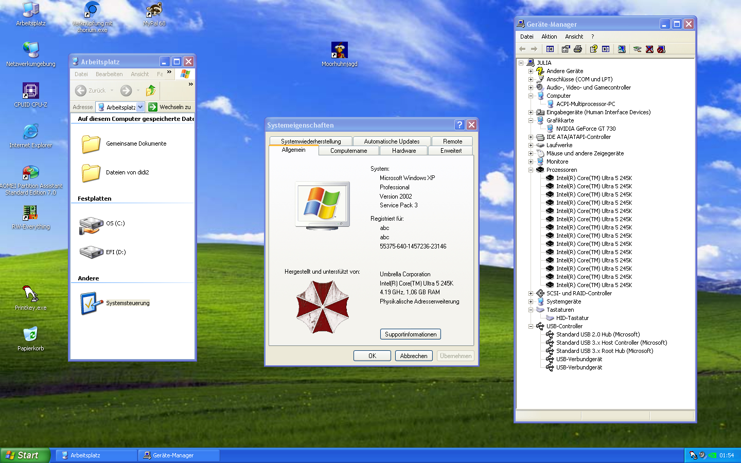

Boot XP SP3 via csmwrap.efi, graphik Radeon 240.
It boots full XP into black screen (sound you hear) or 4 bit color. It boots XP fast.
Disable before Vdt (or similar name) in Bios or you get a blinking cursor.
Have an full XP SP3 with Nvidia driver ready (tested on other board) for the Nvidia GT 730
on that boot medium, that you use for csmwrap.
This GT 730 you connect to another PCI-e slot.
No boot of XP with graphik card in any other slot than Slot1 is possible for the Arrow Lake board.
And then, you connect your monitor to the Nvidia GT 730 on that other PCI slot.
The XP recognices this card via plug and play and its Vid_&Pid number.
This is my crazy nice idea. Voila..
I think, it can be even done more easy, you may start XP via any boot medium, no graphik at all,
and then full graphik via the Nvidia card.
But I noticed a strange thing:
The Bios or XP notice (!), if there is a monitor connected to that card in Slot1 or not.
This makes things much more difficult
Dietmar

I just check again: The GT 730 does not have an Legacy VGA Option Rom.
The Radeon R240 has.
But the Radeon also does not load 55 AA at C0000 because the PCI-bus 1 has not enough resources for it under XP on the Arrow Lake board.
This you can check easy via UEFI shell with dmem 0C0000 40 .
The resources go all to PCI-bus 00. And because of this, also Clover does not help.
I understand everything, what the problem is of the Arrow Lake bord for booting via Graphik card for XP SP3
and also what is the problem of csmwrap.efi: It needs mostly the help of an underlying CSM from a compi, where it is just disabled.
Or it is lost without Legacy VGA Option Rom, waiting of 2 min for to load SeaBios and then black screen.
And on an Arrow Lake board this resources problem appears.
After I understand this, I can boot full XP SP3 to desktop, 32 bit color and resolution as much as I want, 3D driver works to full there.
I disable PCI-bus 01 in Device Manager. Everything works there and is stable
Dietmar
