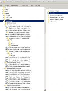

Hi Yzöwl,
unfortunately it does not work really. This is the output I get with the new version:
ROBOCOPY "C:\Program Files\Microsoft DPM\DPM\Volumes\ShadowCopy\Non VSS Datasource Writer\vol_1c79e280-ba21-484f-8f3d-82
a4f4419872\$RECYCLE.BIN" "G:\DPM" /E /ZB /MIR /XD "System Volume Information" /XF "*.mp*" "*.avi" "*.mkv" "*.wm*" "*.m4*
" /LOG+:""G:\copylog.txt"" /TEE /NP
a4f4419872\68be349c-090c-4392-8e80-fdaeb100eddd" "G:\DPM" /E /ZB /MIR /XD "System Volume Information" /XF "*.mp*" "*.avi
" "*.mkv" "*.wm*" "*.m4*" /LOG+:""G:\copylog.txt"" /TEE /NP
a4f4419872\System Volume Information" "G:\DPM" /E /ZB /MIR /XD "System Volume Information" /XF "*.mp*" "*.avi" "*.mkv" "
a4f4419872\$RECYCLE.BIN\S-1-5-21-654489264-3419089459-3909593113-1113" "G:\DPM" /E /ZB /MIR /XD "System Volume Informati
on" /XF "*.mp*" "*.avi" "*.mkv" "*.wm*" "*.m4*" /LOG+:""G:\copylog.txt"" /TEE /NP
a4f4419872\68be349c-090c-4392-8e80-fdaeb100eddd\Full" "G:\DPM" /E /ZB /MIR /XD "System Volume Information" /XF "*.mp*" "
a4f4419872\68be349c-090c-4392-8e80-fdaeb100eddd\Full\F-Vol" "G:\DPM" /E /ZB /MIR /XD "System Volume Information" /XF "*.
a4f4419872\68be349c-090c-4392-8e80-fdaeb100eddd\Full\F-Vol\WindowsImageBackup" "G:\DPM" /E /ZB /MIR /XD "System Volume I
nformation" /XF "*.mp*" "*.avi" "*.mkv" "*.wm*" "*.m4*" /LOG+:""G:\copylog.txt"" /TEE /NP
a4f4419872\68be349c-090c-4392-8e80-fdaeb100eddd\Full\F-Vol\WindowsImageBackup\SECDOM" "G:\DPM" /E /ZB /MIR /XD "System V
olume Information" /XF "*.mp*" "*.avi" "*.mkv" "*.wm*" "*.m4*" /LOG+:""G:\copylog.txt"" /TEE /NP
a4f4419872\68be349c-090c-4392-8e80-fdaeb100eddd\Full\F-Vol\WindowsImageBackup\SECDOM\Backup 2011-08-27 120048" "G:\DPM"
/E /ZB /MIR /XD "System Volume Information" /XF "*.mp*" "*.avi" "*.mkv" "*.wm*" "*.m4*" /LOG+:""G:\copylog.txt"" /TEE /N
P
a4f4419872\68be349c-090c-4392-8e80-fdaeb100eddd\Full\F-Vol\WindowsImageBackup\SECDOM\Catalog" "G:\DPM" /E /ZB /MIR /XD "
System Volume Information" /XF "*.mp*" "*.avi" "*.mkv" "*.wm*" "*.m4*" /LOG+:""G:\copylog.txt"" /TEE /NP
a4f4419872\68be349c-090c-4392-8e80-fdaeb100eddd\Full\F-Vol\WindowsImageBackup\SECDOM\SPPMetadataCache" "G:\DPM" /E /ZB /
MIR /XD "System Volume Information" /XF "*.mp*" "*.avi" "*.mkv" "*.wm*" "*.m4*" /LOG+:""G:\copylog.txt"" /TEE /NP
Press any key to continue . . .It seems like robocopy tries to copy every subdirectory inside the directory that shall be copied extra instead of just the directoy whose name is mentioned in the listfile.
Anyway ... I am using jaclaz´ version now, it works great and I can understand the script. It is not as refined maybe because I have to add all the full paths I need to copy into the list file instead of just the directory name but it works fine.
I really thank all of you guys especially Yzöwl and Jaclaz for spending time to help me and making me understand this
I am so grateful !
Alex

Hi again,
@gunsmokingman: thanks a lot for your vbs script. I would prefer to do it within a batchfile because the process is part of a larger already existing cmd backup script. But if I dont find a good way to do it within a cmd I will come back to your solution !
@Yzöwl: Attached is a screenshot of the directorystructure that I am trying to copy. Those are shadowcopy mountpoints created by DPM (Dataprotectionmanager) so one can copy files from DPM to for instance external Harddrives via non VSS aware scripts or applications. I do not have space on my external HD for all the mountpoints so my intention was to have a list of mountpoints that will then be copied from the directory structure to the USB harddisc like:
vol_9edf29cf-c89a-4fe5-97d6-7c9ce70c13b0
vol_a6f0c2c5-39d7-4e77-ae3b-b8f4fc835b8f
vol_1d53783a-0dcf-4d62-8f11-19c297af3de2
etc.
The script should go over the complete structure below the "C:\Program Files\Microsoft DPM\DPM\Volumes\ShadowCopy" Source directory and copy everythiing below the mountpoints mentioned inside the list.

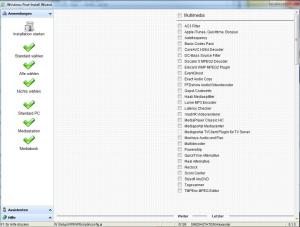

#1 Check 'Show Images In Installer' on Features tab of Options Wizard. (ShowInstallerImages=false/true)
#2 Your category is too long for 1 column. Long time bug in why it jumps it over the second column.
Hi Marc,
thanks. How can I work around that category bug ? Strange, I never had that so far ...
edit: found the solution !
0 -

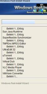

Hi !
Compared to version 8.0.3 I found the following graphical problems (see screenshot).
- In installer the green icons for Success are not showing
- In WPI, the first column on the first page is empty.
I imported all the configuration files from 8.0.3.
