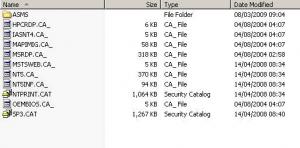

Hi, I use a USB-stick (Sandisk Cruzer) Jaclaz is right. Making a bootable USB-stick with "HP Windows Format Utility for USB Drive Key" works I used version 2.00 and formatted NTFS. I had no success with FAT32. Changing BIOS-settings did not solve the asking for "missing" SP3-files Screenshot shows file names of "missing" files. After setting BIOS-setting back to HD-boot something strange happened. I can not install XP now from the same USB-stick!!. Booting is OK, files are transfered, but at reboot HAL.DLL is missing. -
