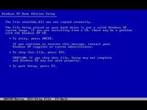

well i edited it and it could not copy the file still :D:rolleyes:
hes the image that proves it!
so anyone know whats wrong? or why its not finding it when it is there? :)
anyone got any idea why it doesnt find it?
