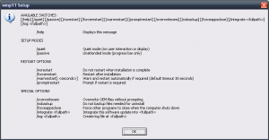

This wont integrate in with nLite since the /integrate option is not there....

See Attached (Unpack wmp11-windowsxp-x86-enu.exe) (wmp11.exe /?)

To integrate IS7 into my setups I used nLite 1.2 Final, it allows the direct integration of the actual IE7.exe into the setup...
As for WMP11, there's an nLite Add-On made by Boooogey who posts on RyanVM's forums who's made an add-on available which appears to work...

Yes, I have changed my method to this. Direct integration of wmp11 and ie7

http://wud.jcarle.com/
wmp11 integrator .. it works
