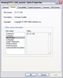

Nice, but your topictitle is a bit wrong, the newest winamp at the moment is 5.111 (when downloading it, you will see 5.11 but after installing it you will see 5.111)
Actually if you look at the properties of the file, you will see 5.1.11.143 as the latest version. The topic title does state the major version numbers. But I think is trivial in this case. smile.gif

where do you read that? i read it on winamp self, see the attachement...
Edit: i already found it, you have watched at winamp.exe to see the version, you have right. it is 5.1.11.143
MHz
Your picture does not reflect the build of the version number. This makes distinction between each version mentioned crazy for us to define the correct version number. wacko.gif
