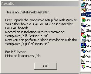

extract installer, if your msi has setup.ini file to guide install, try adding somethomg like:
CmdLine= /qn
under [Startup]
CmdLine is usually blank after =.
_good luck...see attached, other option for pre iexpress tweaking.
