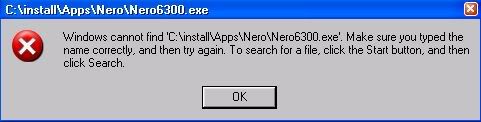

olso i have a problem with Nero and MSN
Astalavista
for nero check this link out.
http://www.msfn.org/board/index.php?showtopic=48407

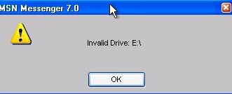

my msn still doesnt work and i need silent install for Bsplayer, FFdshow, AC3filter

Try the /QN switch for msn
This is my code
CODE
ECHO.
ECHO Bezig met het installeren van MSN Messenger 7.0
start /wait %systemdrive%\Install\Hotfixes\MSN7\MsnMsgs.msi /qn

Thanks for help but I think its not problem in switch.

Synapse
that error is because of the path not a switch, check the file name and folders carefully. rename them if need be.
