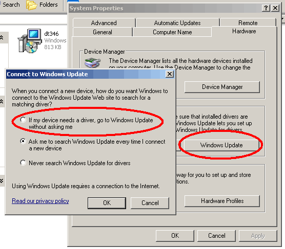

no, i have the same problem, and i know whats causing it.
i tried just installing dtools exe (not msi) and it did the same thing. so it was obviously a sp2 problem.
the cause is that new option to install drivers from windows update. you have to make it NOT ask you (the top option)
the middle option (always ask) is the default. all i need is the registry tweak so i dont have to do this manually, here ill post a screen so you know what im talking about

no, taskill wont work. windows is just asking you if you want to let it download a better driver from windows update, which is a waste of time because you already have the driver. a registry tweak or a script would fix this

i finnaly found the reg tweak so it wont ask me if i want to windows update. but NOW it asks me to search for the driver (it finds it if i tell it to search..)
WHY all of a sudden does it do this!?!? even doubleclicking the file will prompt me now. before (only adding a reg tweak), if i manually disabled windowsupdate driver search, it didnt prompt at all. now im confused..
if anyone knows how to solve this, plz tell us!

here's the error screenshot:
http://www.msfn.org/board/index.php?act=At...=post&id=172809
maybe this is a glitch in SP2?
Robpol86
Aug 20 2004, 02:05 PM
ewww a 900+ kB bitmap
here i compressed it, so people on 56k can help
yes thats EXACTLY what im getting now, cant get around it...
no its not a glitch in sp2, (with dtools 3.46), it worked perfectly for me. now all of a sudden it doesnt....
